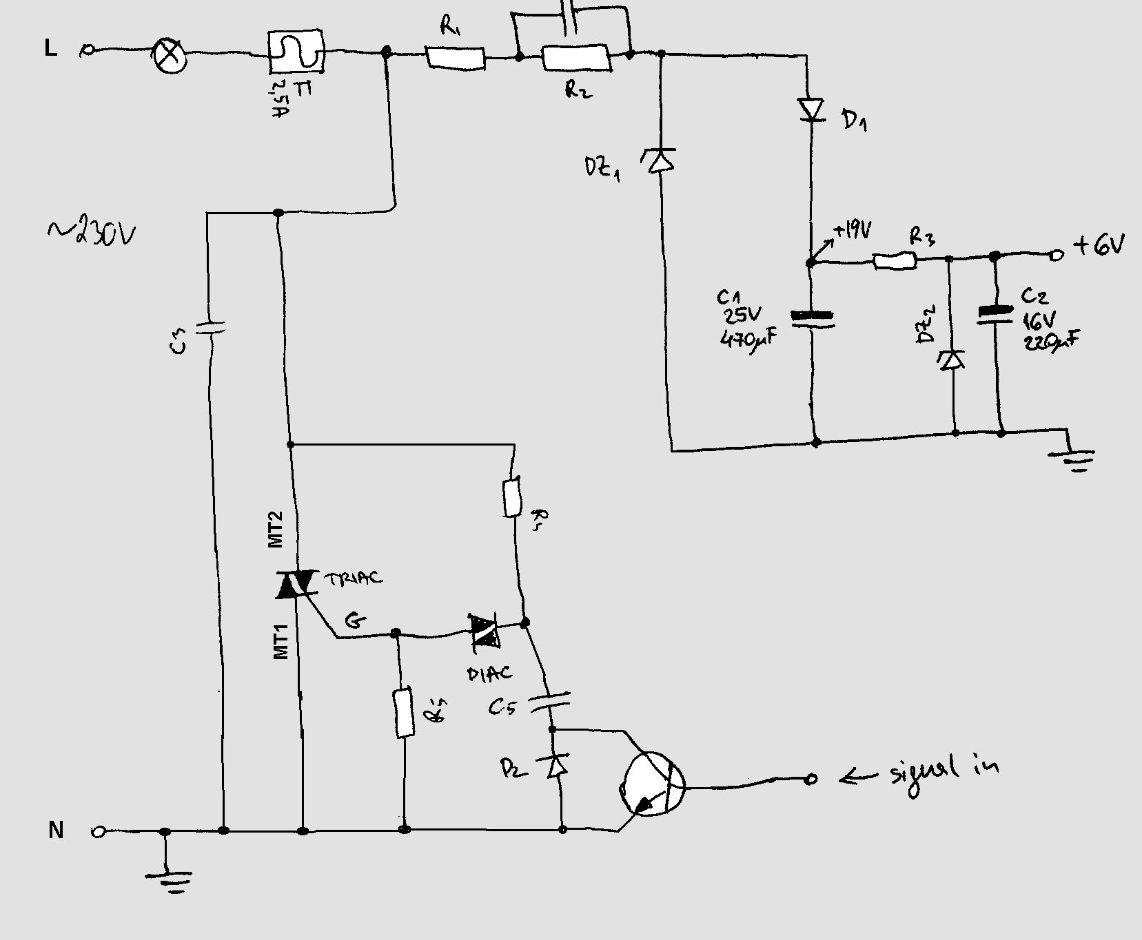

Guys, this is the circuit of the PIR sensor:
If you say that is brilliant I can go to this one, trying to build the same for my project.
I cannot say much about it. I see a diac, somehow controlled by a diode, which on the other side is controlled by NPN transistor. 6 volts are powering the PIR sensor logic, that drives the transistor back.
The C1 is giving 19v and C2 is giving 6v - aways, no matter bulb state.
I am expecting your analysis and comments/ideas on that.

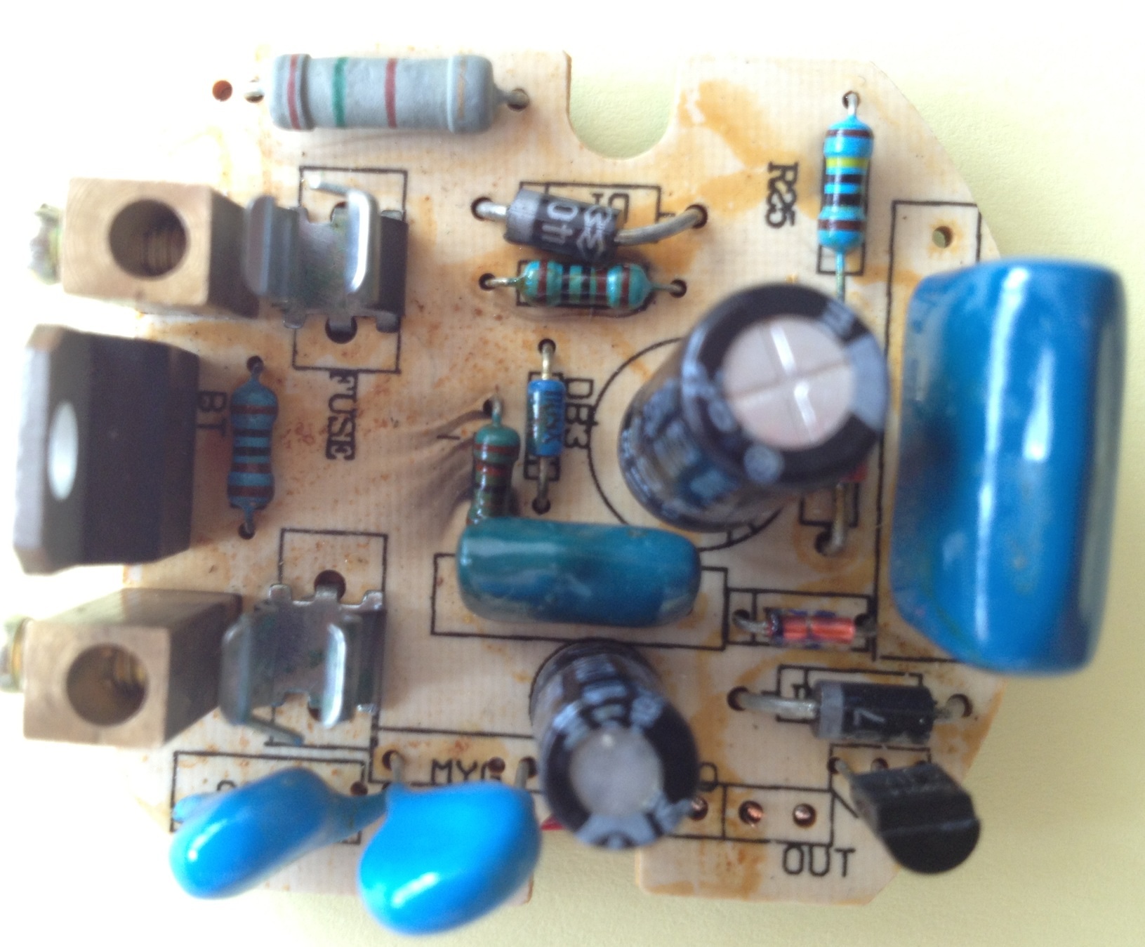

And the PCB photo if it can help at all:

See drawing. I cleaned up the drawing a bit so that we can see the operation of the circuit a little more clearly.
I see a strange trigger circuit where it looks like the triac should be off when the transistor is turned on, but that might require values of R and C not within a reasonable range. Did you try this yet?
Why not use the relay?
The power supply section doesnt look too bad so far.

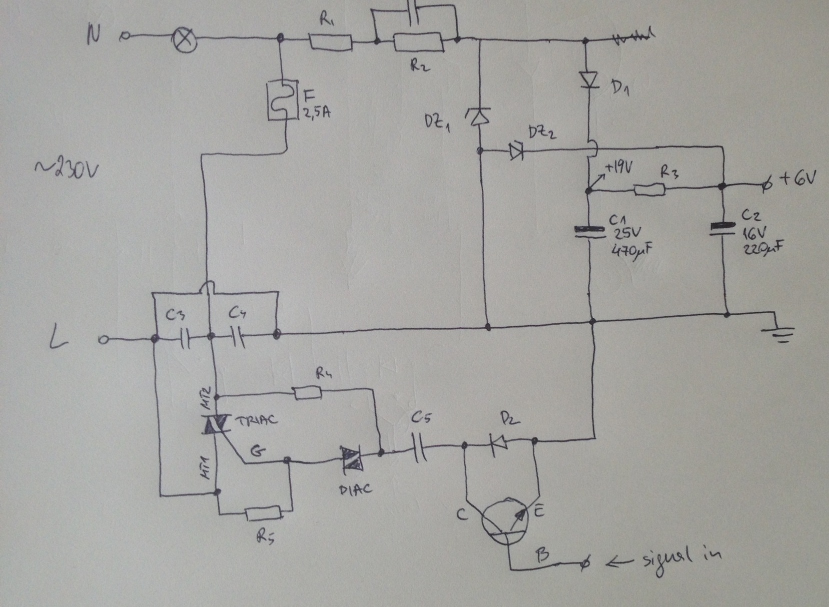

Now I see in your editing there is no cap C4 anymore and now when the triac is on the rest will be shortened?!
You've put the Neutral going to the circuit but actually the Live goes out of the wall, the Neutral is in the ceiling to the bulb. If this matters at all. The sensor works no matter where is the neutral wire connected.

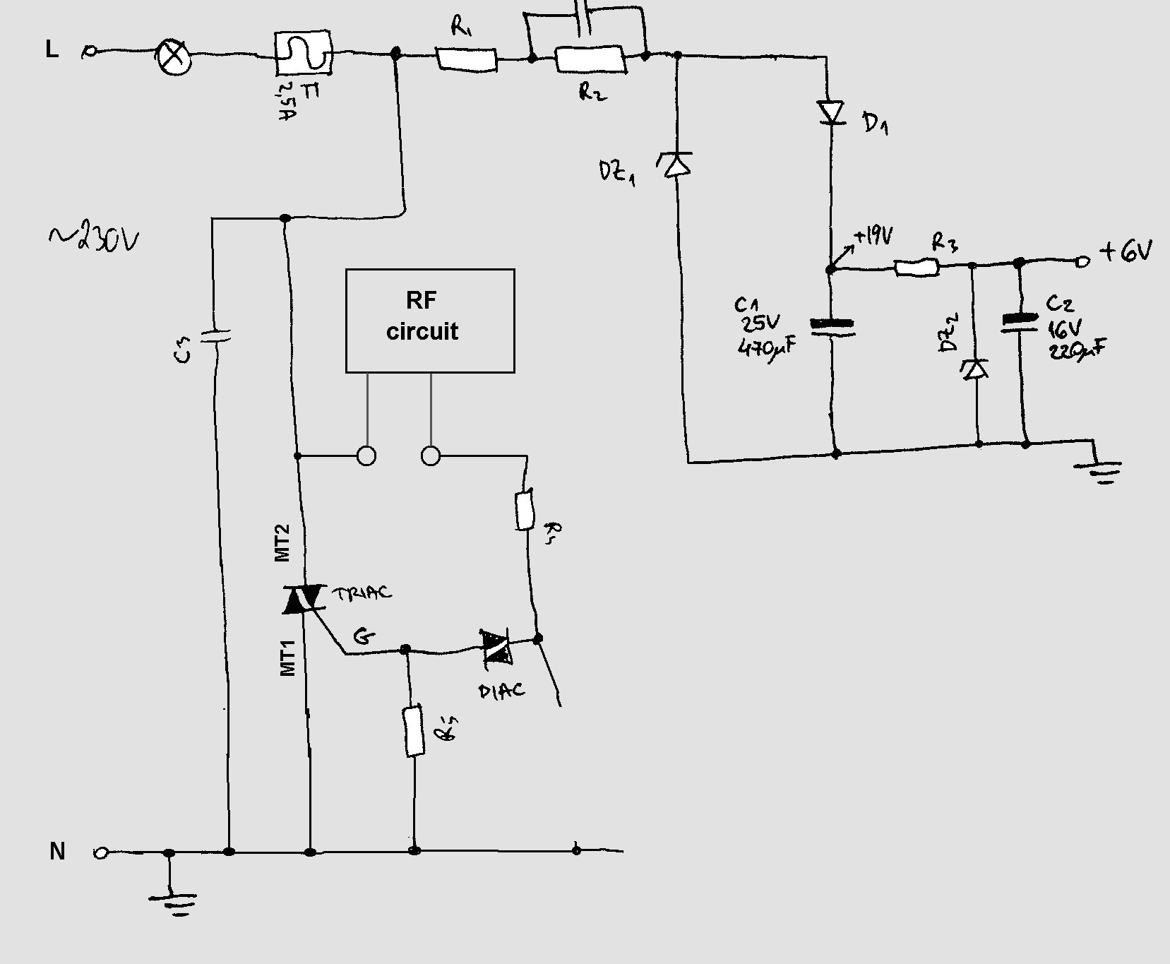

Here is the circuit using the RF circuit. This should be tested.

The PIR circuit (thanks MrAl for cleaning it up!) is based on a principle that I don't think you can use.
When the lights and TRIAC are OFF, the capacitive reactance supply produces enough voltage and current to run the PIR sensor and it's brain.
But once the lights and TRIAC turn ON, there will be very little available power from the cap reactance circuit!
With PIR controlled lights this doesn't matter because they use a "timed on period" which only needs a tiny bit of power. ie; the PIR device and brain etc don't need to be powered when the lights are on!
You needs are very different, as you need a rather high voltage and current (12v 30mA) at all times, even if lights are on.
Thanks a lot MrAl !
Now if that works would be great as the number of elements got less.
I will post in several days the test outcome as I am traveling on a business trip.
Meanwhile you or someone else if can explain in few words how the diac is doing the job would be great.
:) cheers!
Hello again,
The diac is a bilateral device that has a somewhat high resistance when off, and turns on by going to a lower resistance after a certain terminal voltage is reached. They come in various threshold voltages like 20, 30, etc. What this means to our circuit is that the triac wont be able to turn on until the line voltage reaches maybe 30 volts, and then it will come on because the diac will conduct. However, 30v on a line of 230vac means a delay of only around 250us, so we only have 250us to extract all the energy we need for the entire half cycle. That may not be enough so we might have to use a higher voltage diac or two in series. That's one of the reasons we have to test this.
Side note: Once the diac conducts if the line voltage is 30v and the DC power supply voltage is 15v, that really means we can only extract energy AFTER roughly 125us, so we really only have 125us left to extract all the energy we need for the entire half cycle. That's not much so we'll have to see how it goes and increase if needed. We cant go too high though or the bulb will start to dim.

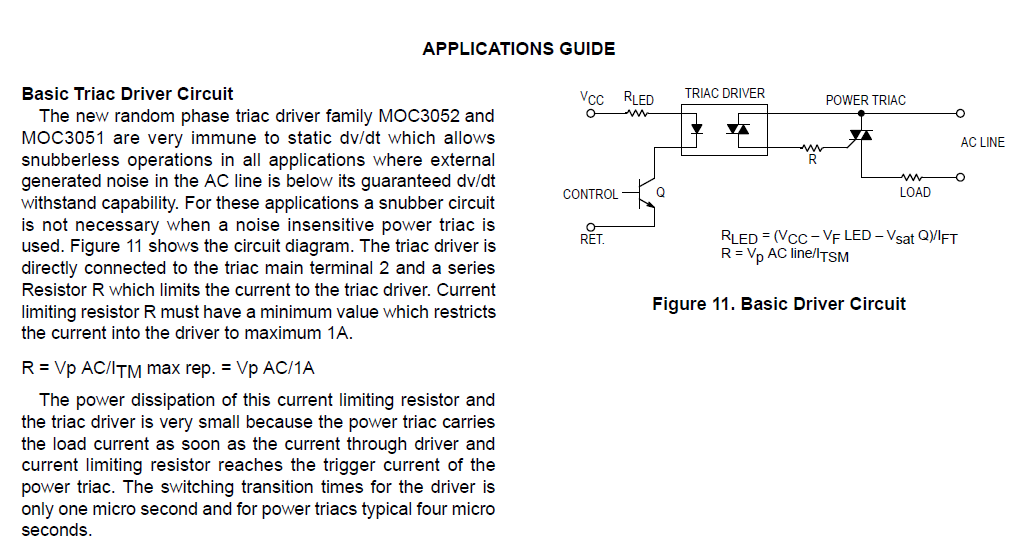

I bought MOC 3052 optocoupler (Random Phase Optoisolator Triac Driver).
Here is the datasheet:
https://www.datasheetcatalog.org/datasheet/fairchild/MOC3052-M.pdf
The circuit they give I cannot understand very much because I cannot determine the resistor values for my case and because I cannot understand why is the transistor.
Can I use this optocoupler insted of the diac circuit? Or forget about the optocoupler and get back to the DIAC thing.
