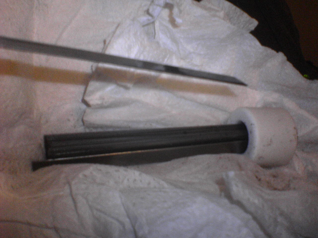

what about a car ignition coil, i just took one of em apart and its core was composed of straight metal plates!?!
Are you sure that's an ignition coil? This is how 'normal' ignition coils typically look.
The laminated soft iron core does look like a stack of straight metal plates.
thats the one!
ya thats it alright , but heres a pic of the core i extracted, to me they look like 1mm thick stainless steel rods, all stacked together, but again , doesnt the core need to be in a loop?
The core of an ignition coil is a solenoid (straight) That's why you can pick them up on an AM radio, the magnetic loop isn't closed. Proper manufacturing of a toroid or pot core ignition coil would be prohibitively expensive. You should have had a loop of wire around that coil. Maybe attached to the case itself.
so if i wound a primary ,secondary and feedbak loop around that core it would work ok?
