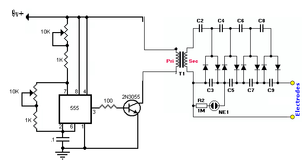

Attached is the schematic i will be using. It is a combination of schematics i found from

Frequency can be adjusted to change taser characteristics.

i can get these following transformers easily, will any of these be helpful?
Primary/secondary 1k ct/8 ohms- Ferrite core- 350mW rating
Primary/secondary 500 ct/8 ohms- Iron core- 450mW rating
Also what do you think about replacing the 2n3055 with an irf540

I see that the 555 astable frequency and duty cycle can be adjusted over wide ranges. What freq do you want to run at?
The fet should work. You want a fet with low gate capacitance. Leave out the 100Ω
I'd go for the 1kΩ:8Ω That is a 11.2:1 turns ratio. Ferrite is usually lower loss at high audio freq.

Only problem i have now is knowing the transformer limit of current on primary because no specs are given, only secondary output specs of 350mW are given.
You will be feeding high power into a low power transformer. It will be instantly destroyed.
