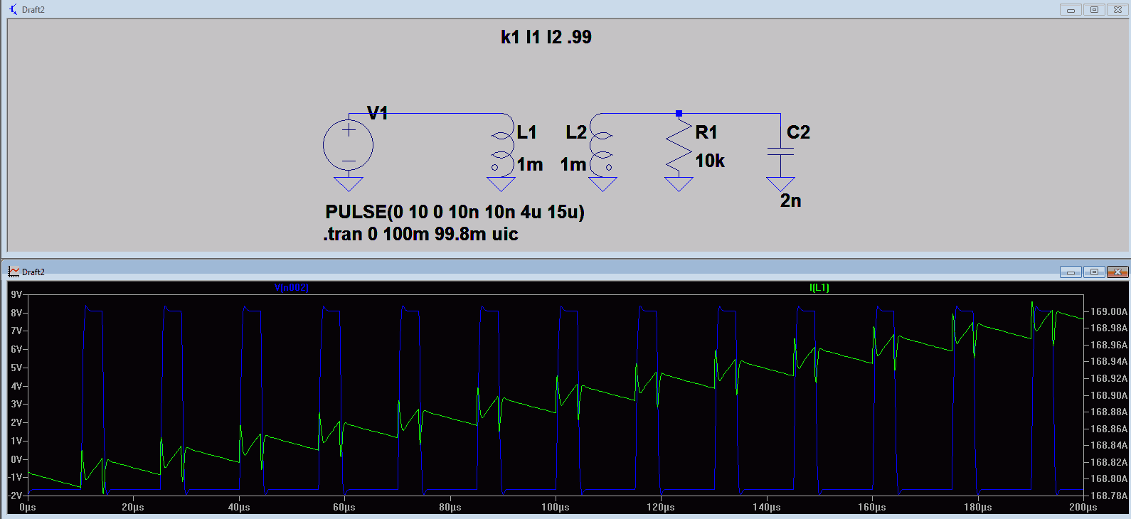

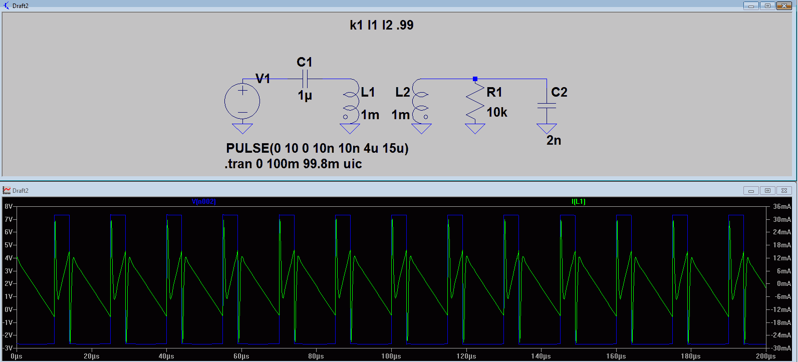

I've attached some pictures in case you're interested; one is the dc-coupled gate drive transformer (GDT), while the other is the ac-coupled GDT. The DC one can be seen to have an increasing inductor current, while the other does not. The trace marked V(n002) is the voltage across C2.

What? As far as I'm aware, the flux in an area is the (area * mag. field) and the mag field is the (current * some independant integral of the length of the conductor). This means the flux is proportional to the field, the field is proportional to the current, and therefore the current and flux are proportional too. So "not the current the CORE FLUX" makes no sense to me.
That document shows says the volt-seconds must cancel out on each cycle or there will be bias. Measuring (by eye) the volt-seconds of the AC-coupled signal (shown in the pictures) across the primary: positive: 7.35V*4us = 29.4u, negative: -2.66V*11us=29.3u. Allowing for reading errors, it's balanced.

had you bothered reading it AND understanding it you would have seen that if you supply a 90% duty cycle to a 10V FET gate you would need a 100V reset pulse in order to reset the core. Are you suggesting he put a +/-100V supply in his system to get a 10-90% duty cycle?
As far as I can see, that's for a DC coupled driver only.
Not sure how you arrived at that conclusion.
As far as I can see, that's for a DC coupled driver only.Not sure how you arrived at that conclusion.
simple, if you need +10V to saturate the FET at 90% duty cycle to keep the volt seconds equal you need -90V at 10% duty cycle 10V*90%=90V*10% there fore you would need a -100V supply to reset the core unless you plan on ordering a custom transformer 1:1:10 using the 10T winding as a reset winding. but that still only gets you to 10% to 90% duty cycle. many PWMs run 1% to 99% or more.
