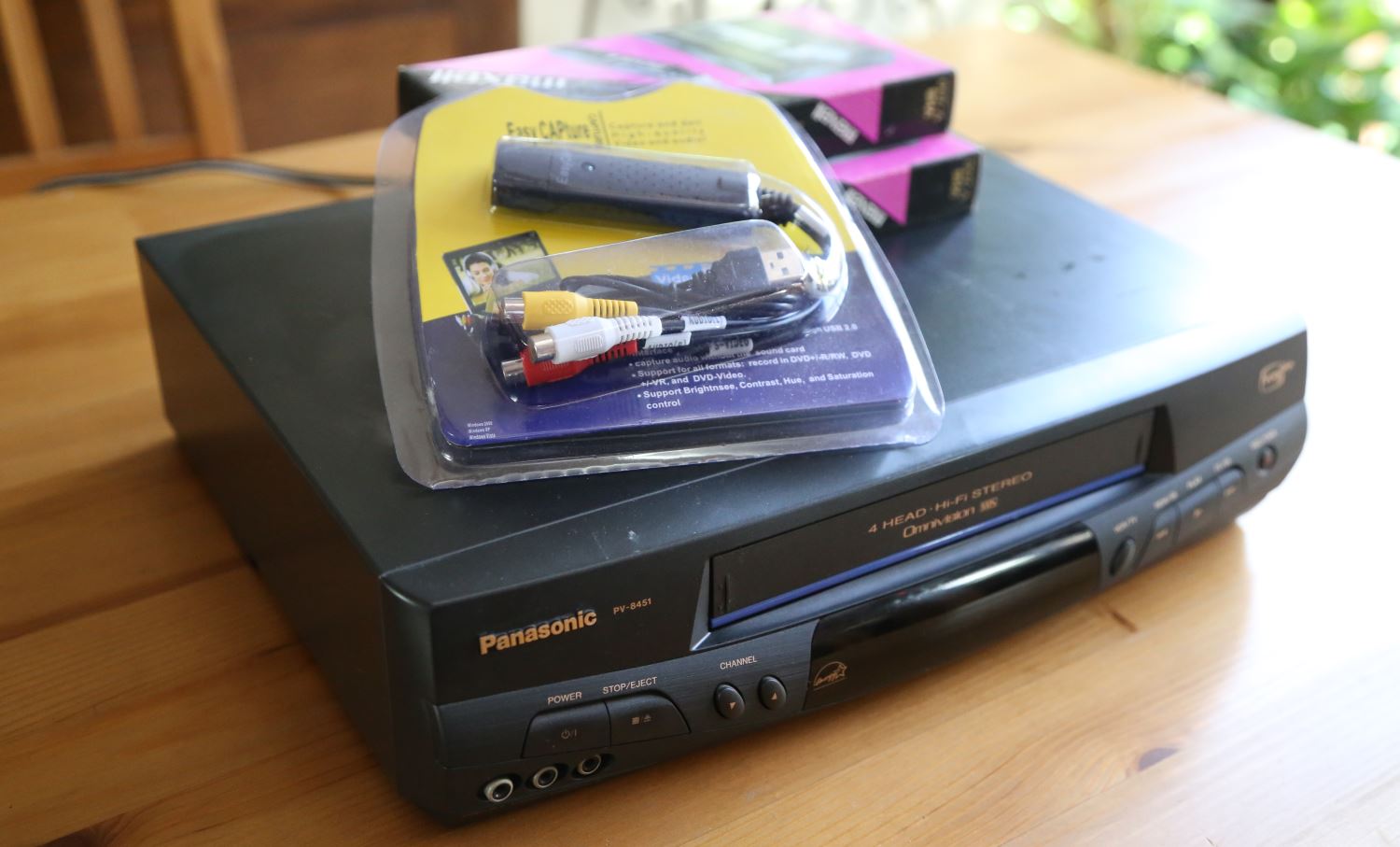

I've got some old VCR tapes that I want to transfer to computer. I "acquired" (was supposed to bin it) a video recorder and can now play the tapes. The VCR has RF and RCA (L-R-V)outputs so I can watch on TV. However, I can't see any way to record to computer. All the TV out connectors output what the TV is tuned to, not what it is displaying.
Is there a (cheap) device that will take RCA and convert to a format I can record? I have a (linux) box which will take RF in but it only recognizes digital signals not the old analogue signal. It also has RCA and HDMI but these appear to be output only.
Any ideas? Thanks,
Hey Mike, you're going to need some form of capture card, something similar to this (The USB one):
Thanks Mickster, that's exactly what I need. Time to see if I can get one locally.

Just ordered one off Amazon. https://www.amazon.com.au/gp/product/B0794WMXXS/ref=ppx_yo_dt_b_asin_title_o00_s00?ie=UTF8&psc=1
Noticed in the description it states free software but in the "package included:" doesn't mention a DVD!! I'll find out next week.

Just wondered what box you will be using this on, because the one you ordered says this:
"OS: Windows 2000, XP, Vista, WINDOWS 7 32 Bit, but not Win 7 64 bit "
Whoops, I'm on Win7 64!!! Luckily, my laptop is dual boot into Ubuntu also (too), wonder if it'll run under Wine.
I've got the exact same unit, works fine on Win10 64 bit. I've never actually used it yet, just tested it - I bought it because it was only £5 or so from AliExpress, and I've got some tapes 'somewhere' :D
I had the tapes but no player. Found a player in school that was to be scrapped so I scrapped it to my lounge. It's a Samsung and no remote to be found but a universal one worked. Will see if this unit will work on Win7-64 or Wine. If not I can easily install Win7-32 on my laptop. The requirements seem very old - CPU: Pentium III 800 above Required!!! May even work installed in "compatible" mode.

During this COVID-19 lockdown, I transferred 15 years worth of my family's VHS tapes.
The way I did it, many years ago I had purchased a VHS + DVD recorder. I suddenly realized after reading the manual (yes, I was that much bored to find appealing to read old manuals) that I could copy the tapes into DVDs.
I know, I know........RTFM :)
So I first transferred them to DVD, and then on my computer played them and converted them to MP4 with the help of AnyVideoConverter share ware.
Sent them to my grownup kids, and saved them both at my hard drive and an external drive.
