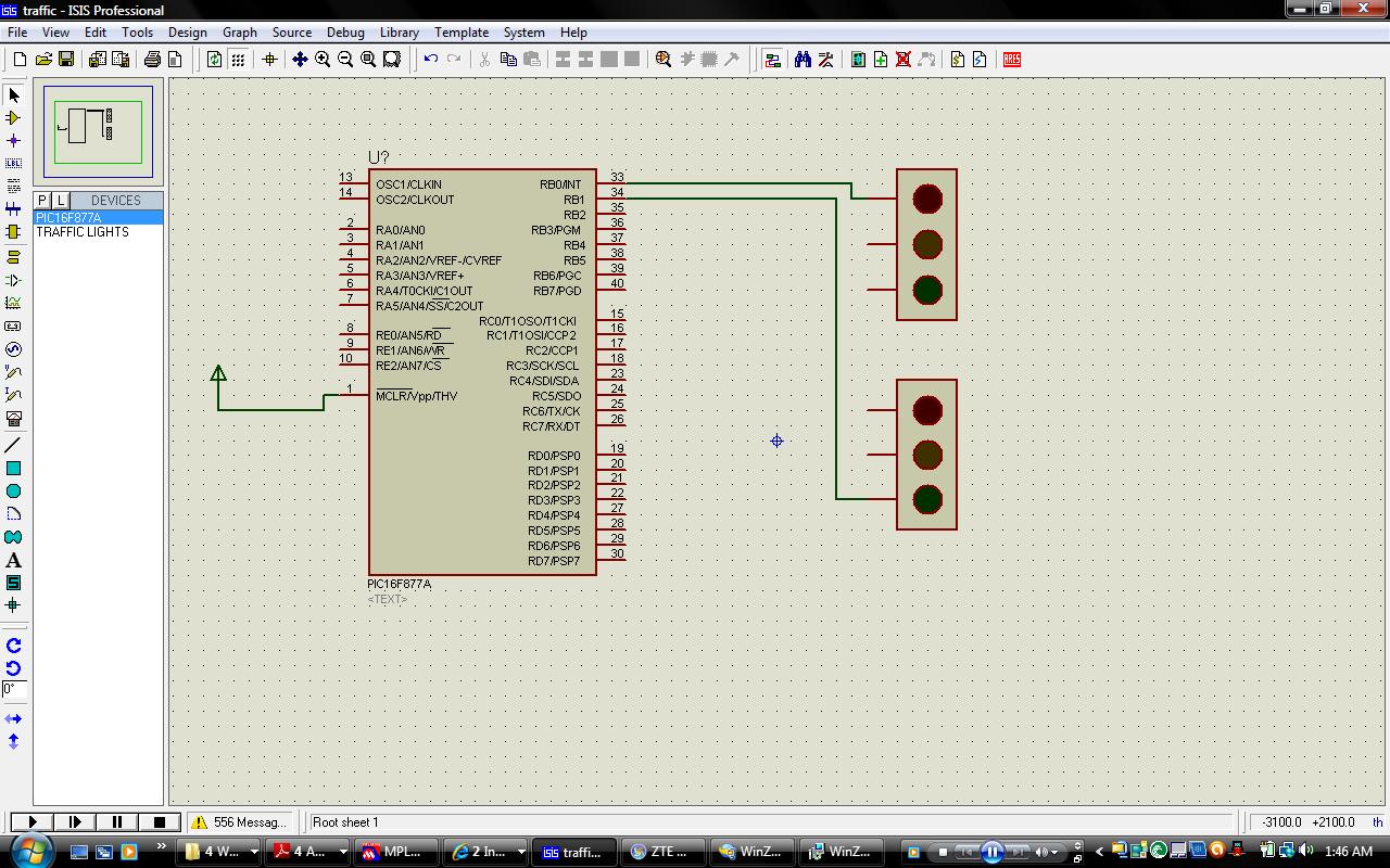

can any one help me. I dont see why my circuit does not work. I am expecting a red light from the first trafic light to be on and the green light from the second traffic light to be on.
below is my code
   list        P=16F877a
   include    "P16F877a.inc"
                __config _RC_OSC & _WDT_OFF & _CP_OFF

I have attached the hex file and my traffic design of proteus
  • traffic.zip
When do the lights turn off? I do not see any code that makes the lights turn off!

yeah I would come to reality, I just wanted to test the lights. If the lights could be on then I would be able to finish this project
You will need to have a delay, and then turn the lights off, and then another delay. You can fiddle around and have them turn on and off in any order if you like.

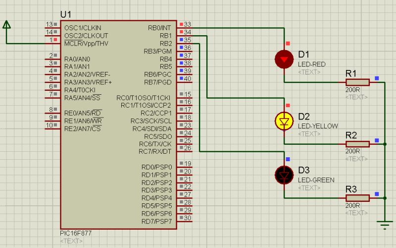

Code tested and works:
tradd-jpg.48413

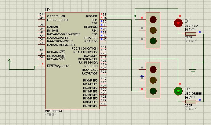

Where did you get that traffic light symbol? it has no DLL for it. Thats why its not working and your code also....

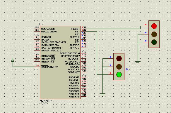

This image is with my HEX with the above code i told you about.
traff-jpg.48414
thanks guys and AtmoSoft, I have been playing around with your circuits Until I realised that my circuit was wrong, the traffic lights needed to be grounded. and after I start my program at 0X00. Then it works fine. now Im gonna build a complete real time traffic light.
