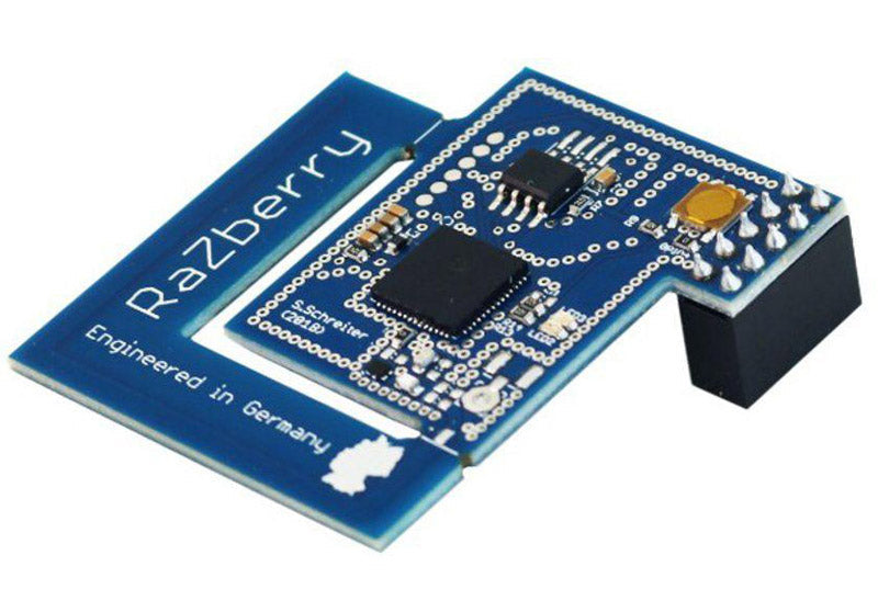

You can get USB stick style Z-Wave controllers that you can use with PCs or a Raspberry Pi etc., so you could build your own main controller while being able to use ready-made sensors and power controllers etc.
Or dedicated Pi add-ons -

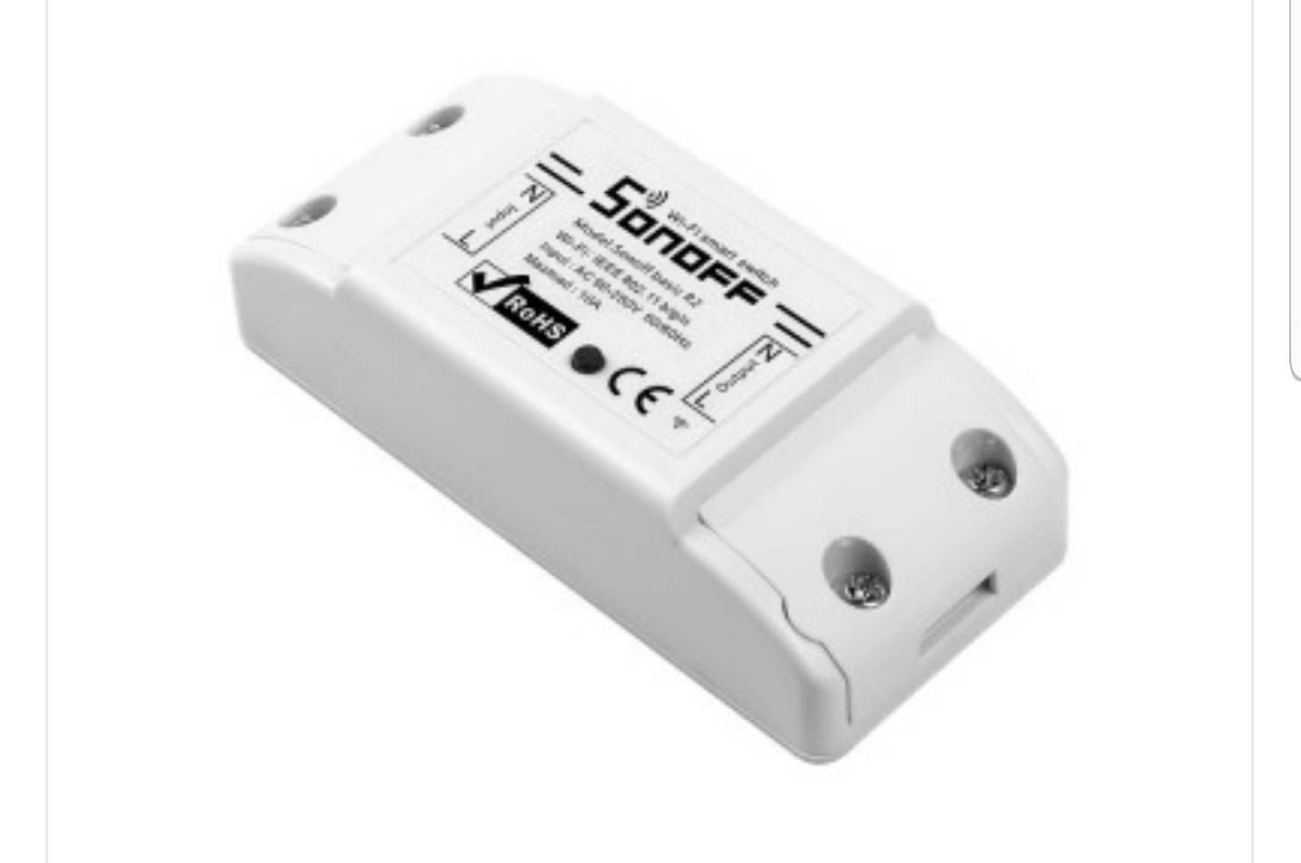

iTead's Sonoff modules start at $5 and are extremely capable. They are based on the ESP8266, have a phone app so you can control them from anyplace in the world and are compatible with Google Home, Alexa and IFTTT. If you don't like the furnished server-based software, they can be flashed with several 3rd party versions of firmware (but this is a one-way trip - you can't restore the original firmware). The Sonoff product line is constantly expanding.
The $5 module is meant to splice inline in a lamp or appliance cord. A typical approach is to splice the module into an extension cord rather then cut up the lamp's regular cord.
I have about 20 of these in operation for more than 5 years now. Very reliable operation.

Except that is buying something completely different, not a smart bulb at all, merely a smart switch - I've had the older (slightly larger one) for years, on a lamp in one of the bedrooms. I've never liked the SonOff modules, but only because I could never get registered to use them - I never got the conformation email back from them. Then, after a couple of years, I tried yet again, and it worked! :D
As Pommie mentioned way back at the start of this thread, you can easily make a Wemos compatible switch yourself anyway, and use their apps :D (I did it as a matter of experimentation a while back, for both single and multi channel options).
