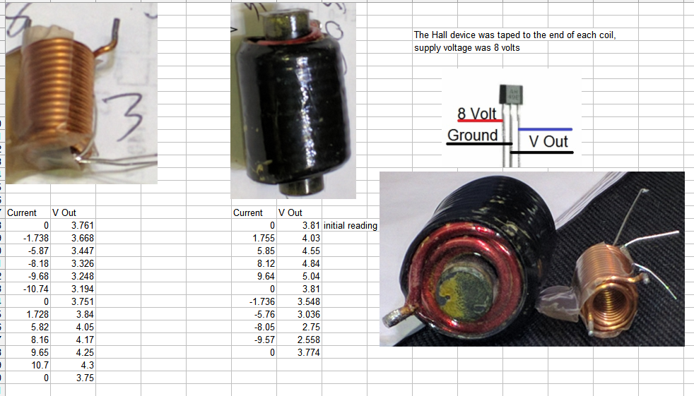

I was trying to use a torroid core with a slot cut in it and a hall effect device placed in the slot to detect the current through a wire. (Image 1 & 2) I used a A3144 (On-Off) and an Honeywell SS495A (ratiometric). With the A3144, with the current one way, it would turn on and stay on, I had to reverse the current to get it to turn off, with the SS495A, it started with one voltage reading, I would add current, and remove it and then have a different voltage reading, add and remove current again and the reading would change some more. It finally dawned on me that the torroid core was magnetizing. My next attempt at a solution was to use a ferrite core induction (#3) and things worked like I thought they should, the A3144 turned on and off at about the same current level each time and the output of the SS495A returned to it's static level after current was applied and remove. I haven't tried inductor #4 yet.
Jeff
What you are seeing is magnetic remanence.
If you want to use a toroid, you have to use a very low-perm material, which usually also posses very low remanence.
Micrometals #2 material could be a suitable option.
The problem I'm having is that most of the inductors I have are salvaged so I don't know what the core's material consists of. I didn't get a chance to try the air core yes, I hope to do that tomorrow. The one that is working well is just like the #3 with 6 turns of wire

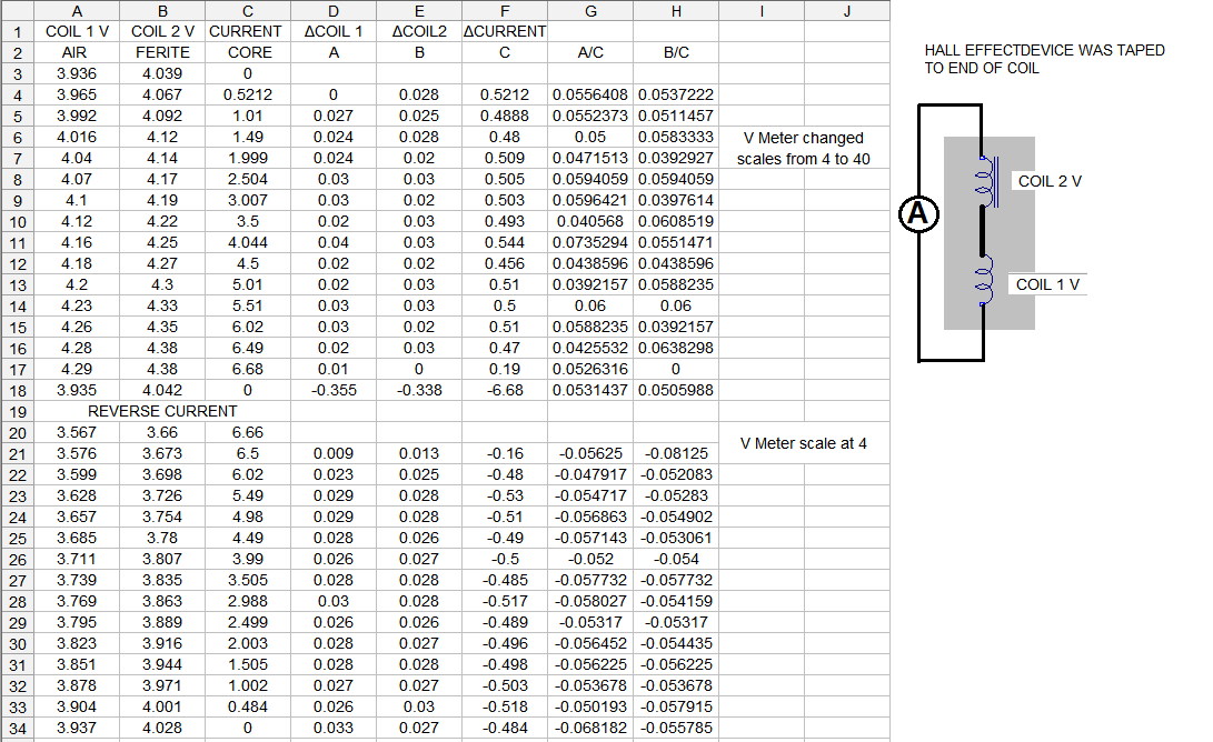

Here's the coils I tried and the results I got using the Honeywell SS495A, I believe there is some potential for this set up.
Jeff
Try the test again, if the 0 reading is caused by remanence then the reading will be completely different next time.

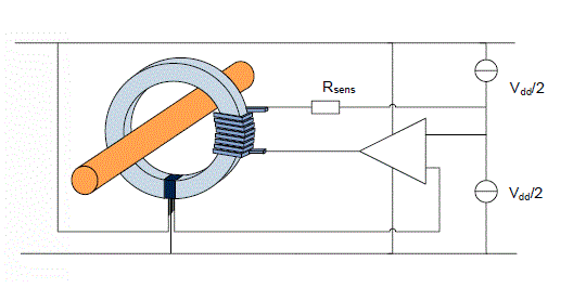

Hi there,
I dont know where you got that drawing from but that's not the way to do it. It looks like a very basic way to construct a current measuring device, but only in the most basic sense. A practical design needs magnetic feedback.
In the more practical design, the op amp you see in that drawing is used with a driver to energize a SECOND winding on the same core. This second winding and current in it cancel the magnetic field effect from the current in the primary winding (current to be measured). Because of the turns ratio, when the current in the secondary is a certain level that exactly cancels the current in the primary, the secondary current is related by a constant to the current in the primary. So for an ideal example, if the primary has 1 turn and secondary 10 turns, if the secondary current is 0.1 ams then the primary current is 1 amp, when the "magnetic balance" is satisfied. This is again a take on the ancient dual pan weight balance, where when the weights match the unknown weight is related by a constant to the other weight and the constant is related to the placement of the fulcrum, and the other weight is the calibrated standard weight used to compare.
So to be practical, you need a second winding, driven by an appropriate circuit, and using the Hall Effect sensor to detect when the field has been brought up to the original intensity before any current was applied. To get a zero, you can use an adjustable offset circuit.
Note that once you do it that way the core will always be at the same level. If it does get magnetized however, you may have to use a degaussing circuit too or else just try adjusting the offset.

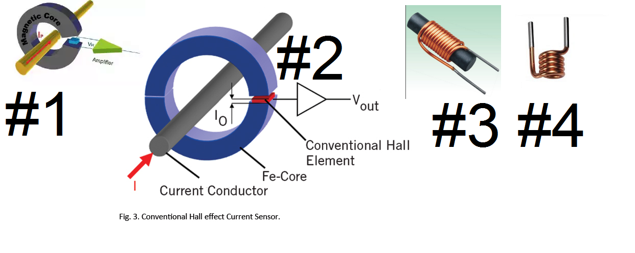

Got the drawings from googling "hall effect current sensor" , there were a few that showed feed backUntitled.png but most did not, your suggested method and it's comparison has got me thinking, using feed back is like balanced scales, and the lack of is like measuring with scales using springs. That probably why the measure gold with balance scales.

In the pic you posted the hall effect measures the magnetic field and the op amp applies a current in the coil to counter the magnetic field produced by the red wire, the current from the op amp being used as the measured signal.
I have a couple made by Abb, however they are for Ac, I suspect Dc ones are arranged such that the offset produced by remanence is small compared to the lowest measured signal.

Got the drawings from googling "hall effect current sensor" , there were a few that showed feed backView attachment 100170 but most did not, your suggested method and it's comparison has got me thinking, using feed back is like balanced scales, and the lack of is like measuring with scales using springs. That probably why the measure gold with balance scales.

I did it again
Seems to remain fairly stable, not as stable or accurate as a LEM current transducer #HX 03...50.P/SP2, <1% Accurascy, Out put is 2.5 v +/- 12.5mv per amp.
Jeff

A closed loop system is shown in the picture.

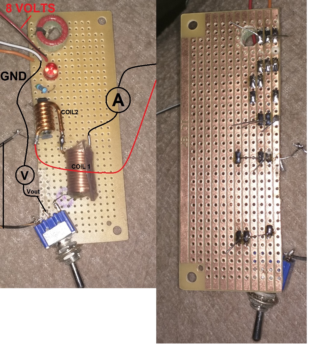

IMG_20160629_161508.jpg Here's my test bed, One Fluke 87 for current, one for voltage, switch for measuring coil 1 or 2. the output lead on coil 2 looks like it contacts the coil, but it doesn't. The toroid has an a3144 in it and if I send current through the toroid and turn on the LED, the LED stays on until I reverse the current, I have something similar that came off the control board for a spa that did the same thing, but it wasn't a toroid, just an open loop of metal in a plastic case to house the hall device, that's the one that got me started on this project, I originally blamed the supplier for sending me latching halls, but they didn't latch when triggered with a magnet, I had to know why! It was remanence.
The whole idea, for me, behind this is to shut down the power to a 12 volt power steering controller when the steering reaches the end of travel and the current goes locked rotor, fried many a FET by holding it turned too sharp. The first unit I built had a chain drive and I could mount vanes on the links to break the magnetic field and shut it down, Then I got a more sophisticated drive train and had no where to put the vane and I've been trying to figure out a current sensor for some time. I think this may be it. I can use an air core winding and adjust the sensitivity by how many turns on the coil, I think. No remanence with air cores. :)

View attachment 100202 Here's my test bed, One Fluke 87 for current, one for voltage, switch for measuring coil 1 or 2. the output lead on coil 2 looks like it contacts the coil, but it doesn't. The toroid has an a3144 in it and if I send current through the toroid and turn on the LED, the LED stays on until I reverse the current, I have something similar that came off the control board for a spa that did the same thing, but it wasn't a toroid, just an open loop of metal in a plastic case to house the hall device, that's the one that got me started on this project, I originally blamed the supplier for sending me latching halls, but they didn't latch when triggered with a magnet, I had to know why! It was remanence.

Oh yes, very nice. The air core has the disadvantage of not being able to 'amplify' the magnetic signal. Back when i experimented with this i found that almost any metal like even steel would increase the field and thus give a higher reading. Even a black binder clip would work to some degree because the spring part is made of steel.
The best cores are the ones made for magnetic applications, but yes there are other things that have to be considered. With an air core you'd just need more turns i guess as that makes the field stronger:
B=N*Idc*Kair
The main basic advantage a core has to offer is a higher field intensity per winding turn. Since a single winding turn has a certain resistance, then N winding turns has resistance that is N times one winding turn, and so the fewer winding turns we can get away with the lower the resistance of the entire winding.
Since the multiplication factor for a core can be easily 100, using even a low mu core leads to 100 times the field intensity and that means 100 times the sensitivity. So for a core that needs 10 winding turns to read 1v on the meter with a certain current, that same size coil with an air core would require 1000 turns. Pretty big difference right? Even a common 10 penny steel nail might have a mu of 10 to 100.
That's only the tip of the iceberg too, because many cores have mu factor of 1000 not just 100, and so that always leads to less turns.
