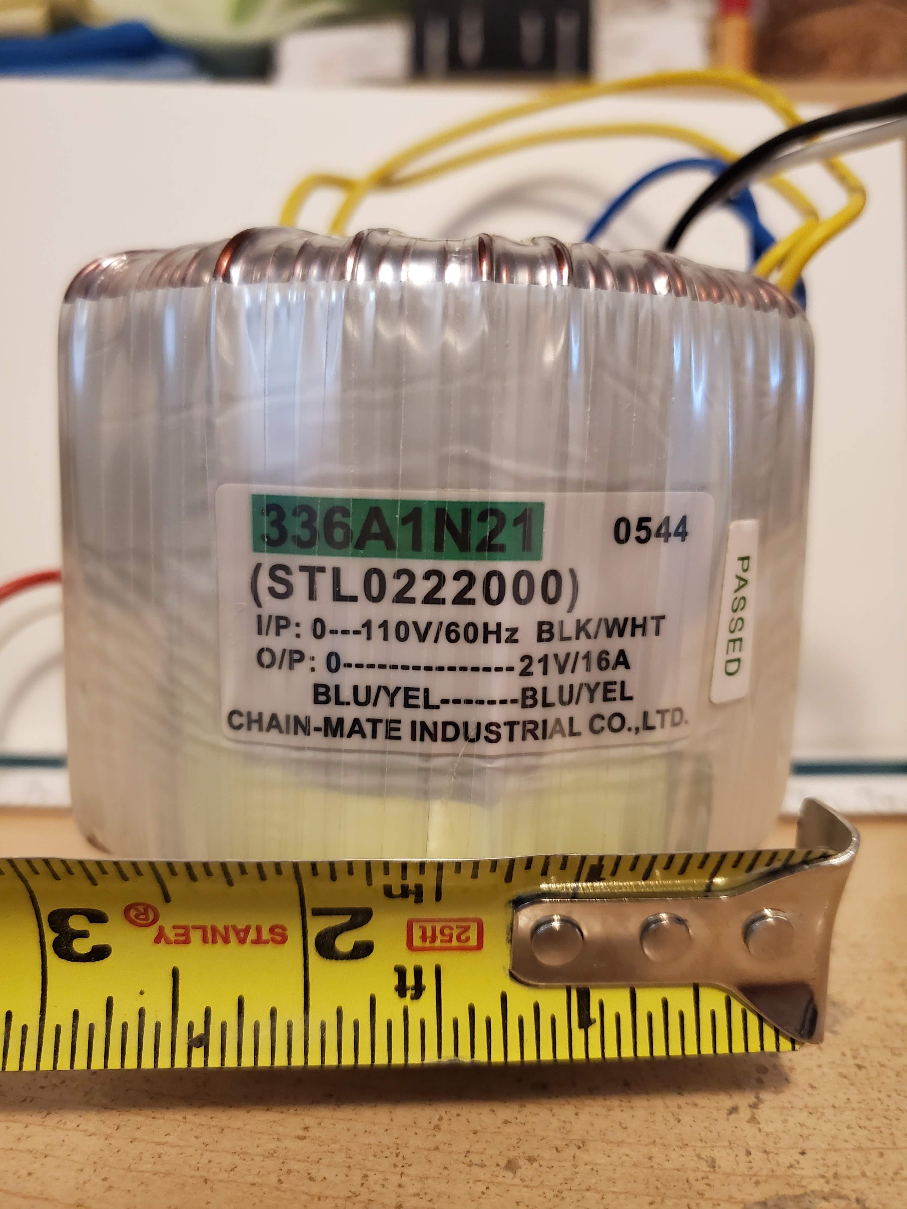

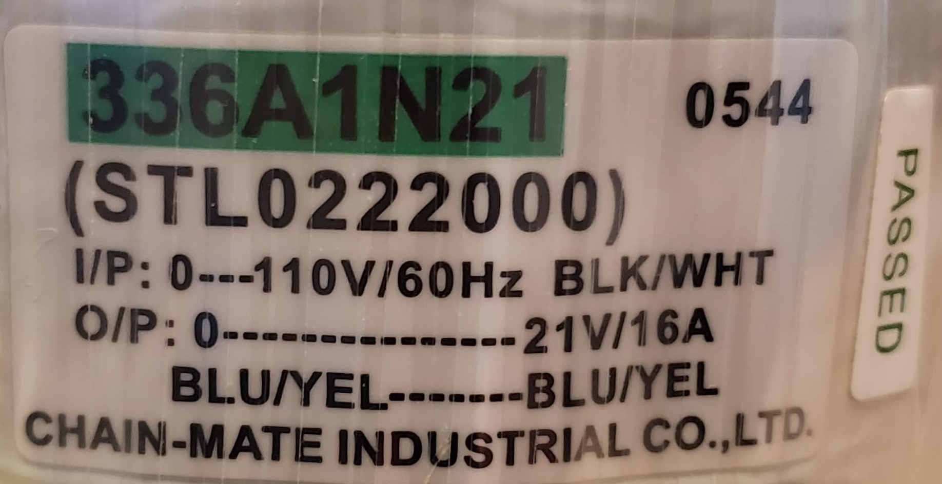

Hello all.
Looking for an expert to advise me on replacing a failed toroidal transformer on a massage chair. The control circuit is functioning, but the actuators are not. Voltage testing indicates no output from this transformer. An ohm check of the input leads (black & white) shows as open (failed?). Doing the same check on the output leads (any combination of the blue/yellow) indicates connectivity.

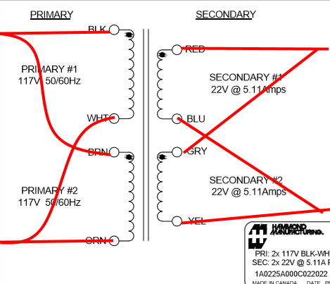

As near as I can figure the following is the closest to a replacement part as I can find online.
Hamond 1182P22 (https://www.newark.com/hammond/1182p22/transformer-toroid-44v-225va/dp/54X7533).
Should I buy one?
Thanks for the advise.
Toroidal Transformer, Power, 225 VA, 2 x 22V, 44V, 10.22 A,
Interesting what the description is when you order the transformer but the data sheet gives me the idea that it is rated at 10A at 22V (or 5A at 44v)
120438
16A
120439

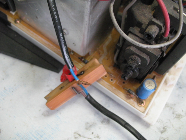

I've seen clothes pegs used as insulators keeping live mains wires apart. Paper used like insulation tape on mains. Copper wire fuses that end up destroying copper tracks and everything else in the way.
It's a miracle that so few house fires are heard of here.
