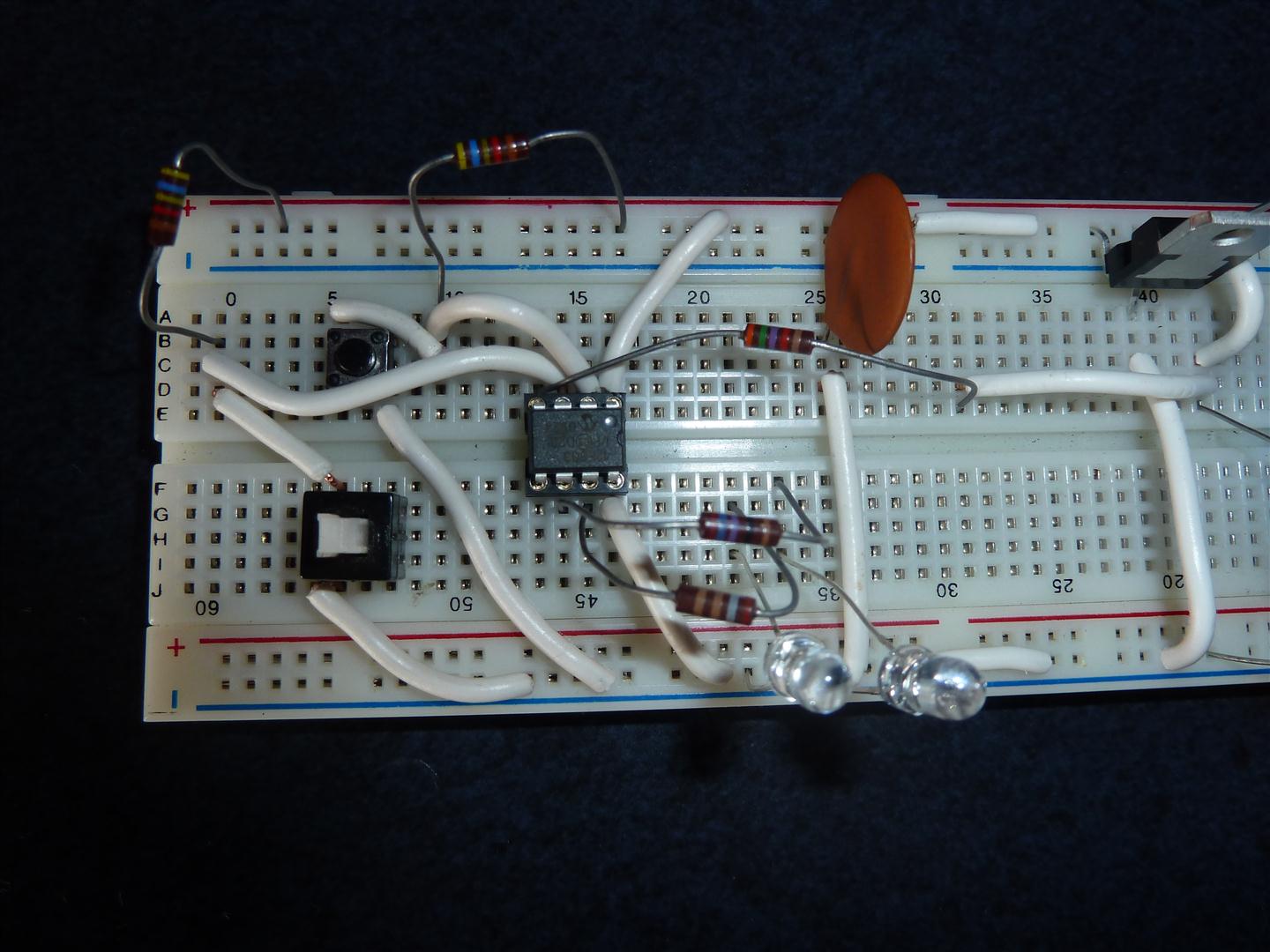

Okay, I have built the circuit now. I activated it by turning it on and off a few times.
Each time I turned it off and on again the flash led incremented and flashed 1 time more than last.
I am using a momentary button as switch a and a latching one as switch b because its all I had in the toolbox.(which I am pressing on then off again)
I have tested them for continuity so I know they are wired up correctly. I may be having some debouncing issues with switch a as it doesn't always show an action.
Switch b doesn't seem to actually do anything.
Can you run through how it is set up for me?
Looking at the code it seems like you have set sw a as the on time so it sets the amount of time the relay will be open for and flashes the led the same number of times.
Sw b is off time and seems to flash the led as well so how is that set?
Originally I was after switch b to activate the on timer when pushed and also cancel the process and sw a to set the timer and the flashes to be a part of the sw a so they flashed after each press, however the way you have written it is slightly different to that isn't it so can you run me through the setting process please.
Also, is there still a 1 minute timer after activation to get the thing to the waters edge when sw b is pressed to activate the timers?

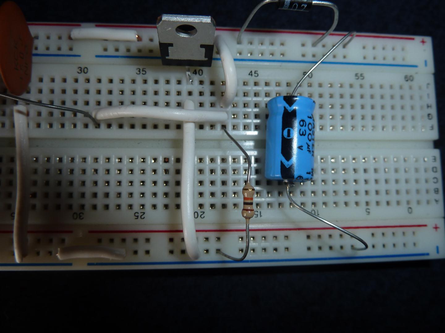

Okay, so I think the circuit is not quite right. I measured from just after the output to ground and I was getting 9 volts.
I am sure I have oriented the regulator the right way. I have included 2 photos of the circuit breadboarded. Can you see anything wrong with it?
Better sort that out before moving on.
I dont have a variable power supply(been intending to make one for a while) so I used a dc power pack with a 9v output so clearly nothing is getting limited at the regulator at all.
EDIT. I see what I am doing now. I have conencted both pins of the regulator to the power rail. Will sort that out now.
All sorted now. Measuring 4.9v after the output.
