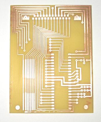

I am about to start a new project for a USB controller board for controlling solenoids on pneumatic valves, this is the Valve control module, which will daisy-chain to another transistor board and then to the 24vdc solenoids.
I would like to start off by doing the toner printer/transfer method for this board, as I've never made a PCB before. Do you think it will be possible on this board? Dimensions are 65mm x 59mm. Here is the board:
If the traces are too thin, could I use my Adobe photoshop and make the traces a bit thicker (I'm a graphic designer, so this is easy for me)? I really dont want to get involved with the expense of a photoresist setup, as I'm not sure I will be making many of these.

I would recommend something a bit simpler for your first boad but this board isn't too complex for torner transfer although I would tend to choose the photoresist method for something like this.
How thick are the tracks?
I generally wouldn't go below 0.25mm but I normally use 0.5mm as there's no point in making it any harder than it needs to be.
I've had good results from magazine paper but others here will probably swear by other proprietary papers such as Press 'n' Peal which might be a better option here.
sorry to state the obvious, but you'll want to remove the gray components layout information from your artwork, since you're printer will either print it as black, or as some sort of dithered, either way, it'll mess up the pcb
since you mention retouching things, filling in the drill-holes so there's only a dot in the center will help make it easier to drill. some of the clearances are pretty tight there, for example the one trace leaving the usb connector makes a few 90 degree turns and to me, it looks like it nicks the other pad of the usb connector.

Hi Guys,
Have been following the thread and thought I would try the mag paper instead of the usual expensive Press and Peel.
Works a treat - no worrying about is the iron at the correct temp -just full on.
Apart from two patchy lines at the very bottom of the board, everything perfect, much better, particularly for first try, than P & P
Pic attached, dark outer areas photo effect not bad tracks.
Only problem , hope she won't miss those glossy pages ! -well I'm not going to use my mags , now am I !
thanks
Richard
