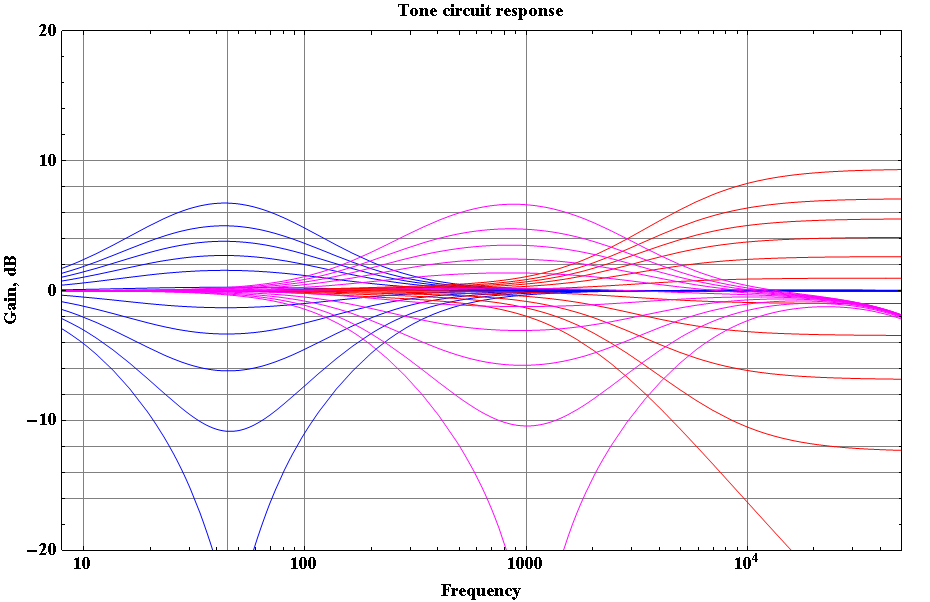

Here are a couple of images showing the response of the circuit with the fixed gain set to zero.
The first image shows the response with the component values given by the OP. The bass control is not providing a shelf type response which is rather atypical; it's more like a mid response. There should be a capacitor across the bass pot, and no capacitor in series with the wiper to get a shelf response.
The 22 pF capacitor (C16) is causing a bit of HF rolloff.
The curves are close together when boosting and not so close together for a cut. A pot with a taper could help make a more even characteristic.

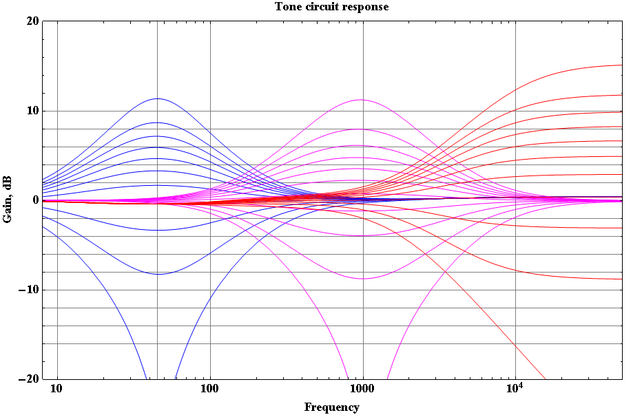

The second image shows the response with R17 and R22 changed to 3k3 and R25 changed to 2k7. I reduced C16 to 2 pF to display its effect on the HF response of the mid circuit.

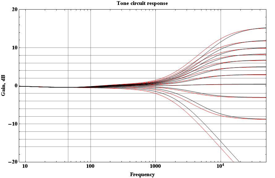

Hi thanks for the time and effort you put in its really appreciated, I have been told to lower C13 to 820pf to avoid high frequency rolls to early when changing r22 to 3k3 do you think that's correct.
The attached image shows in red the behavior of the treble control with R22=3k3 and C13=1000 pF.
The black curves show the effect of changing C13 to 820 pF.
I leave it to you to decide which you want.

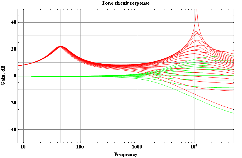

...I wanted to do a numerical analysis rather than a simulation so that i could study the component sensitivities and perhaps come up with an optimum set of values. Dont know if that's going to happen today but i'll see if i can get to it as i think it will be interesting.
You are apparently using the word "simulation" to mean the use of a canned Spice program such as LT spice, PSpice or Microcap in distinction to "numerical analysis". AFAIK Spice does what it does using numerical analysis. I'm guessing that when you say "numerical analysis" you mean setting up the network equations and solving them yourself, rather than letting Spice do it. However, to me, any method that involves solving network equations mathematically is simulation, compared to soldering up the circuit and making measurements.
I produced the plots by solving the network equations directly, not with a Spice program. The final expressions are cumbersome and certainly mathematical sensitivity analysis would be possible, but there are a lot of variables and massive number crunching would be involved. The sensitivities would vary with frequency and would be best presented as graphs rather than lists of numbers. It might be just as well to do what I did in the previous post and show the characteristic curves before and after changing one component. The human visual system is good at processing data in graphical form.
Of course, just showing the sensitivity of one component doesn't find an optimum set of component values. But, what will be the criterion for "optimality"; minimum sum of squares of the various sensitivities? This would require a lot of number crunching, even for a circuit as relatively simple as this one. Please do report your results if you do decide to do this!
I took the opamp gains to be ideal, not decreasing with increasing frequency, but sensitivity to opamp parameters would be one thing to investigate. For example, a phenomenon known as "Q enhancement" can take place in active networks such as this. If I make an extreme change in the opamp gain and plot the response of the treble network, the effect can be seen. I changed the opamp gain to about 3.8, which seems to be the worst case. The green curves show the response with an ideal opamp, and the red curves show the response with fixed gain of 3.8.
