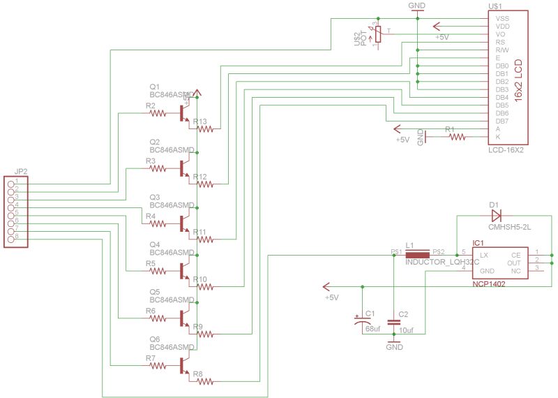

in fact to save money i will use transistors... 6 to be exact and simply switch the 5v.. 6 transistors cost me like $0.18 cents
might take up slightly more board space but heh .. ill use the BC846 its a General Purpose PNP... nice and cheap and simple
Not sure. This was going to be for sale in my store... i wanted it to be usable by any MCU...
Here is a image of my schematic ... i think it will work well. If i use a 1k resistor for the base of each and a 100 ohm i should be able to get about 20mA for each pin even tho they need like 2mA .... but it wont pull more than it needs i guess...
While it will be for sale the schematic will be OPEN SOURCE just not the PCB since i did that work really

Here a nice Link looks like there was a level problem using the 3.3 on some LCD have a look https://delphys.net/d.holmes/hardware/levelshift.html**broken link removed**

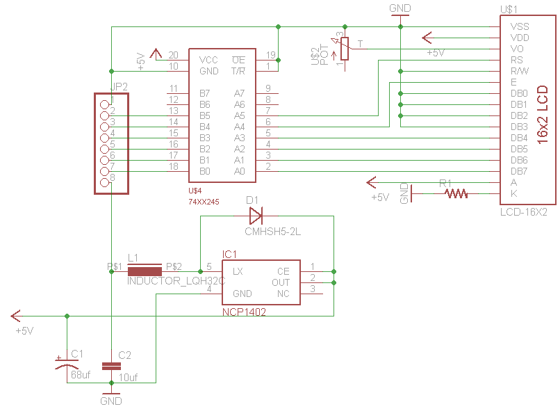

HEH COOL! Of course it would cost more to do that. Counting resistors and board space. Here is my current schematic using that IC.. i just need to order some to test it out now heh... ill get a couple DIP ... oh wait i think i have some here ! YAY!
Anyway here is the schematic:
(AS A NOTE: i dont connect the POT to VCC seems to work way better just limiting it to GND)

THAT IC is a 74xx245 variant. We used it a lot when we only had micro processors. Great chip with the paired pins physically located across from each other on the chip.

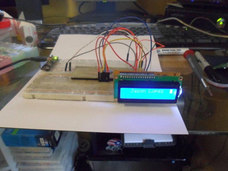

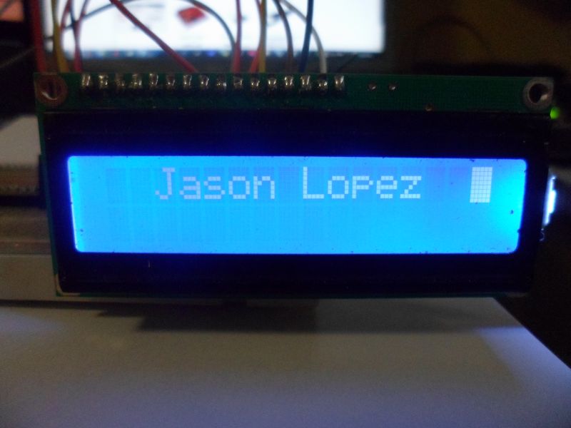

YAY! it works take a look. all running from 3.3v

You have some of them cheap LCD to they work fine I like the blue I got 6 of them for $1.50 each and shipping was cheap to ended costing less then 2.50 each
O and I want my screwdriver back LOl Looks nice.
LOL on the scewdriver. These LCDs cost me $6 each lol not cheap for me. You got lucky! I just uploaded a video:
https://www.youtube.com/watch?v=buBa96gg9D0
The cool thing is i can now use this LCD on 3.3v with no problem! so i can make the PCB using a SSOP and make it smaller Also might make the POT SMT and on the back so you can adjust while its plugged in
