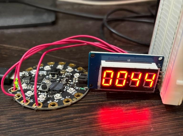

has anyone work on TM1637 display with a 18f4550 or a other microchip model ?? a simple code for it with oshonsoft language??
Removing the capacitors does not work, I tried increasing or decreasing times and I couldn't get it to work. When I put the capacitors back in worked again. It might be a lot of noise around here, I don't know. I also don't have capacitors of this size at home to test with other capacities.
Check several times that you removed the correct capacitors and verify that the lines were not bypassed by excess tin.

I am just implementing one version, but using a Pic Assembly for the 2wire I2c like com's..
Have you looked at some of the available links to other attempts.?
They show either C+, Arduino or assembly code, but the text may help.
There are a few versions and digit sizes out there.
All appear to allude to removing the too large a value caps on the two signal lines.
They require LSBit first rather than the usual, most significant first.

- But I have had the 4-digit tm1637 display working for a long time.
- Regarding the capacitors of the CLK and DIO lines, when I removed them, they stopped working, this does not make sense, I just made sure that the removal of the capacitors was correct and I did not make any mistakes, but I have not continued testing.
