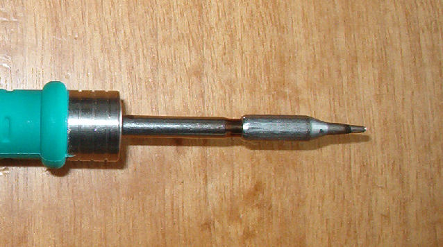

I always try to keep my tip clean. So, when I tin wires, for example, quite a lot of solder remains in the tip. I usually clean it with a dump sponge.
If left half a minute, tip starts to get darker, so to avoid this, I melt some solder on it. But sometimes I need to do very accurate soldering, like SMD points, or reapiring tracks, so I can't have much solder on the tip.
Am I doing things right? How could I improve?

Basically wipe the tip immediately before you use it, NOT when you replace it on the stand.
Is your iron temperature controlled?.
The iron I was using till now it is fixed temperature 14W.
Now I got a soldering station so I can set temperature from 100ºC to 400ºC. I suppose lowering temperature will help ?
No, it's not 'fixed temperature' there's no temperature control at all, so it gets too hot when not in use, this is the main cause of the tip changing colour.
Set it for the temperature you need, the control system will keep it fairly constant.

I suggest you set it to the temperature that works for you, too low and you might have trouble soldering - but normal soldering temperature doesn't discolour the bits.

I wouldn't suggest using an abrasive cleaner on the tip, even a mild one like a scouring pad - modern tips are usually plated (Antex ones have always been!), and it would damage the plating and eventually wear through it.
BTW, I've just bought a new soldering station at work, as the 24V internal controller ones I've used for years are no longer available - I've bought the Antex 660 TC soldering station https://www.antex.co.uk/. I've currently got it set to 275 degree C, which seems to cope happily with either leaded or lead-free solder.

Afeter using my new cartridge for an hour or so, a black "ring" appear. It's the first time I see something like this. Do you find it normal??
I used it at 300ºC, and clean it with a dumped sponge (and destiled water, the one used in car battery)
