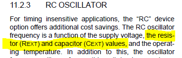

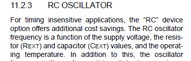

The problem was i think it has internal RC oscillator i will connect crystal and tell what happen..
Can you point to the section describing the internal oscillator? I could not find it. Moreover, if there is an internal RC oscillator, you would need to include some statements to assign the frequency. You did not include those.
Why not follow the datasheet? It is the best option you have. Have you confirmed that you have a working oscillator? If not, why not?
Edit: There is simply no mention of an internal oscillator of any type. Please review this:

hi ritesh,
What are the R/C values of your RC Oscillator circuit.?
