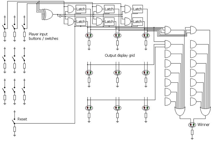

Hey folks,
I need some help and advice regarding the tic tac toe circuit which have to make this semester. I have this unconnected basic schematic diagram and I need to know what you people might think about it since I really need your valuable feedback. This is my very first electronics project and I want to make it cool and big. The main thing I am looking for is how should I extend the schema and if possible, how should I reduce complexity of the circuit. Also please inform me if there is any kind of programming needed since am not very good at it.
Thank you

[What you posted looks like an incomplete schematic that you're supposed to fill in for your assignment.] [Edit] On closer examination, it actually looks like a complete schematic, assuming the input is completely manual (players flipping switches).
It actually looks like the answer is already given.
Two winning combinations are shown, ask yourself how to wire the rest of the winning combinations, for both players.
It doesn't look like this game is designed to compete against a human.
It's just an electronic playing board.
If that were the case, then you'd have a lot more to think about.
