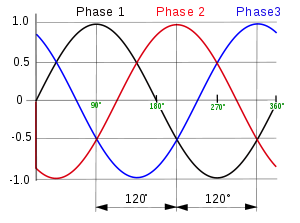

This is not that hard you can figure it out with this
You don't need a "table of three phases" you just need a table of 1 phase, and then read data from 3 different points in the table.
It helps if the number of samples in the table can be evenly divided by 3.
I think I used 1/4 of a sign table and used math to get the other 3/4 of the table. AND did this with 3 pointers to get 3 outputs at the same time.
