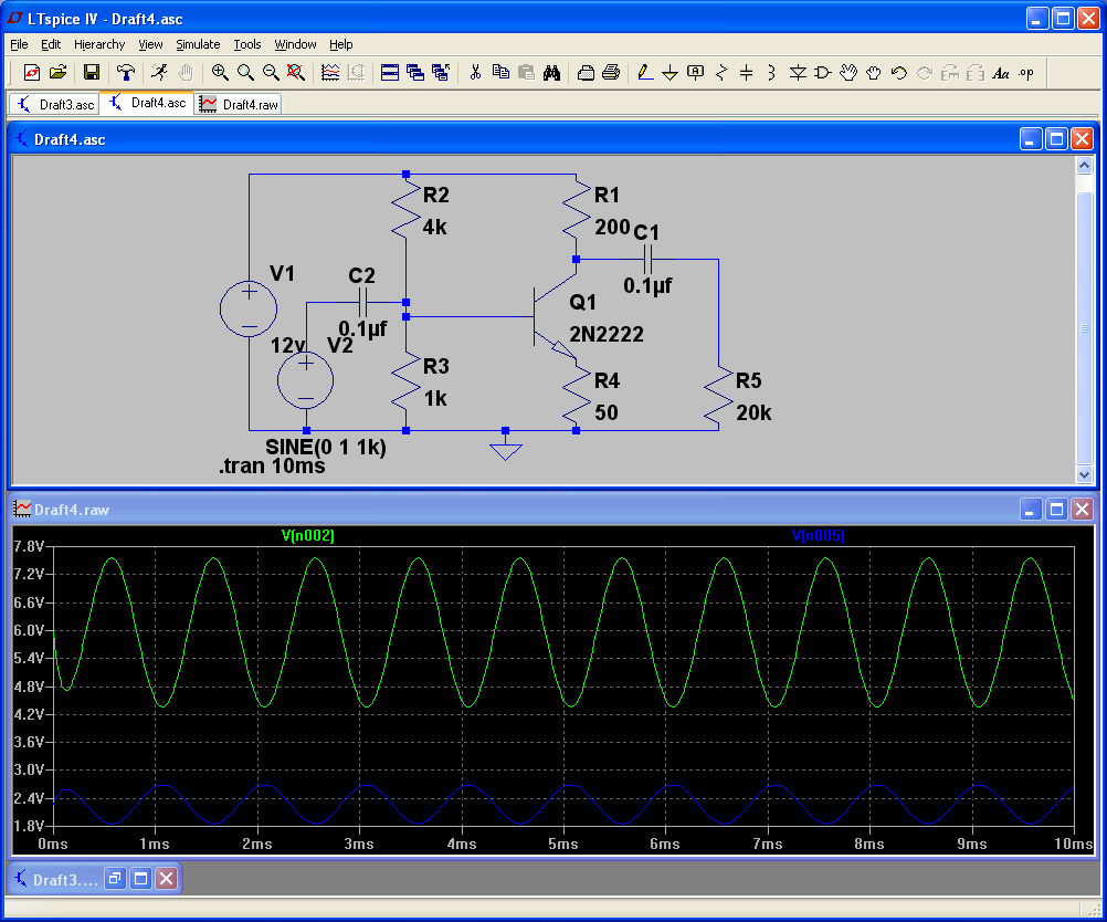

The transistor is not biased correctly. Without the signal generator shorting its base to ground, measure the DC collector voltage. It should be a little higher than half the supply voltage but instead you have it biased wrongly with its collector saturated very close to ground.
The green trace is the collector voltage.
The blue trace is the base voltage.
Note: C2 is added. The base resistors are changed to bias the amp so the Collector voltage will want to go to 1/2 supply.

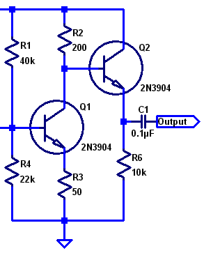

OK, now I'm getting somewhere. Here's the latest iteration of this experiment, which is now a (working) part of my previous experiment, a triangle-wave generator:
(full simulation file attached below)

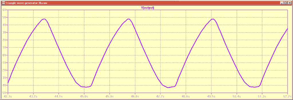

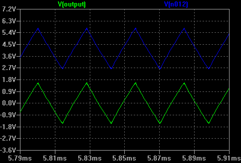

And here are the resulting output waveform plots:
Not bad if I don't say so myself. I added an emitter-follower output stage to give a low output impedance, and therefore a better ability to drive a load. If this was a working instrument I'd probably replace the emitter resistor with a potentiometer to adjust the output. (Well, and the whole thing still needs a bit of tweaking to improve linearity, but that's a separate issue.)
One question: what would I do to bring the bottom of the output down to 0 volts? (Level-shifting, right?) And what if I wanted to make the output signal swing symmetrically around 0 volts? I noticed in playing with earlier versions of the amp experiment that I got an output that did just that, swinging from ~-2 to +2V. Is this even possible with a single supply, or do I need + and - supplies to do this? Trying not to complicate this too much (but we do loves complexity, don't we?).

Add a resistor (e.g.10k) from the output to ground and your output voltage will swing above and below ground.
Your new transistor amplifier has a voltage gain of roughly R2/R3= 200/50= 4 times as you show.
The resistor values for R1 and R4 for the base current of the first transistor are too high for the high current caused by the low resistor values of the emitter and collector.
If the supply voltage is 9V then the collector to emitter current in the first transistor is about 20mA. Its hFE is about 200 so its base current is about 0.1mA. The current in R2 and R4 is only slightly more than 0.1mA but it should be 10 times the base current to allow for a transistor having an hFE lower than average.
R1 should be 4k but nobody makes 4k so use 3.9k. R4 should be lower than 2.2k because in your circuit the value of R1 was much too high then R2 did almost nothing.
The emitter-follower does nothing because the value of its emitter resistor is much too high. An emitter-follower is not needed anyway because the value of the collector resistor R2 is so low at only 200 ohms.
As Alec_t said; add a resistor to ground. When you added C1 things changed. If you looked at the OUTPUT with a scope or a meter (anything with some resistance) you will find the center of the waveform is at ground with peaks going + and -. You have lost the ability to pass a very low frequency signal or DC.

This is not a real world situation. You are looking at OUTPUT with out a load. A 1meg ohm resistor in a scope probe will cause the output to do just what you want. Blue is the collector voltage while green is the OUTPUT voltage with a 10k to ground. This is normally not done because the amplifier (capacitor) will not pass low frequencies.
Ah, yes, a load, like you'd find in real life. Note to self: always simulate a load. Thanks for that!
(Although I'm still mystified by how a single-ended circuit like this, one with a single supply, can produce a negative output at all ...)

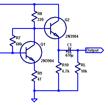

So thanks to all so far for your indulgence. Wonder if I can pick your brains a little bit more.
Here's my output amp so far:
Works OK, sorta, but I want more. I'm only getting a gain of about 4 here.
Here's what I'd like: more gain (~10 or so), a relatively high input impedance and a low output impedance. I think I have the low output Z with the emitter follower. Seems like this should be doable with these little xistors, no? I'm not asking too much here, am I? (And a Vcc of 9 volts.) Ultimately I'd like to be able to get maybe 3.5-4V p-p out of this (again, not asking too much of a 9-volt supply, am I? or is that too close to the "rails"?).
I know I should be hitting my books and figuring this out for myself, and really, I plan on doing that, someday soon, but in the meantime I hope someone will forgive my laziness and at least give me a hint or two ...

The gain is a little less than R8/R9= 220/47= 4.68 times only if the input signal has a low impedance because of the negative feedback provided by R7. Increase the gain by increasing the value of R8, reducing the value of R9 or both. It works well with a higher output level when R9 is 33 ohms.
The emitter follower has a high output resistance for the downward swing of its output so it should be eliminated or added to the input of the gain transistor.

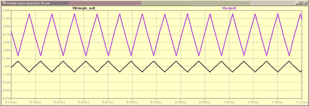

But when I change R9 to 33Ω, the output waveform degenerates:
(this is with a 12V supply)
Hmm, not quite sure what you mean by that: are you saying to put the emitter follower before the gain stage?
