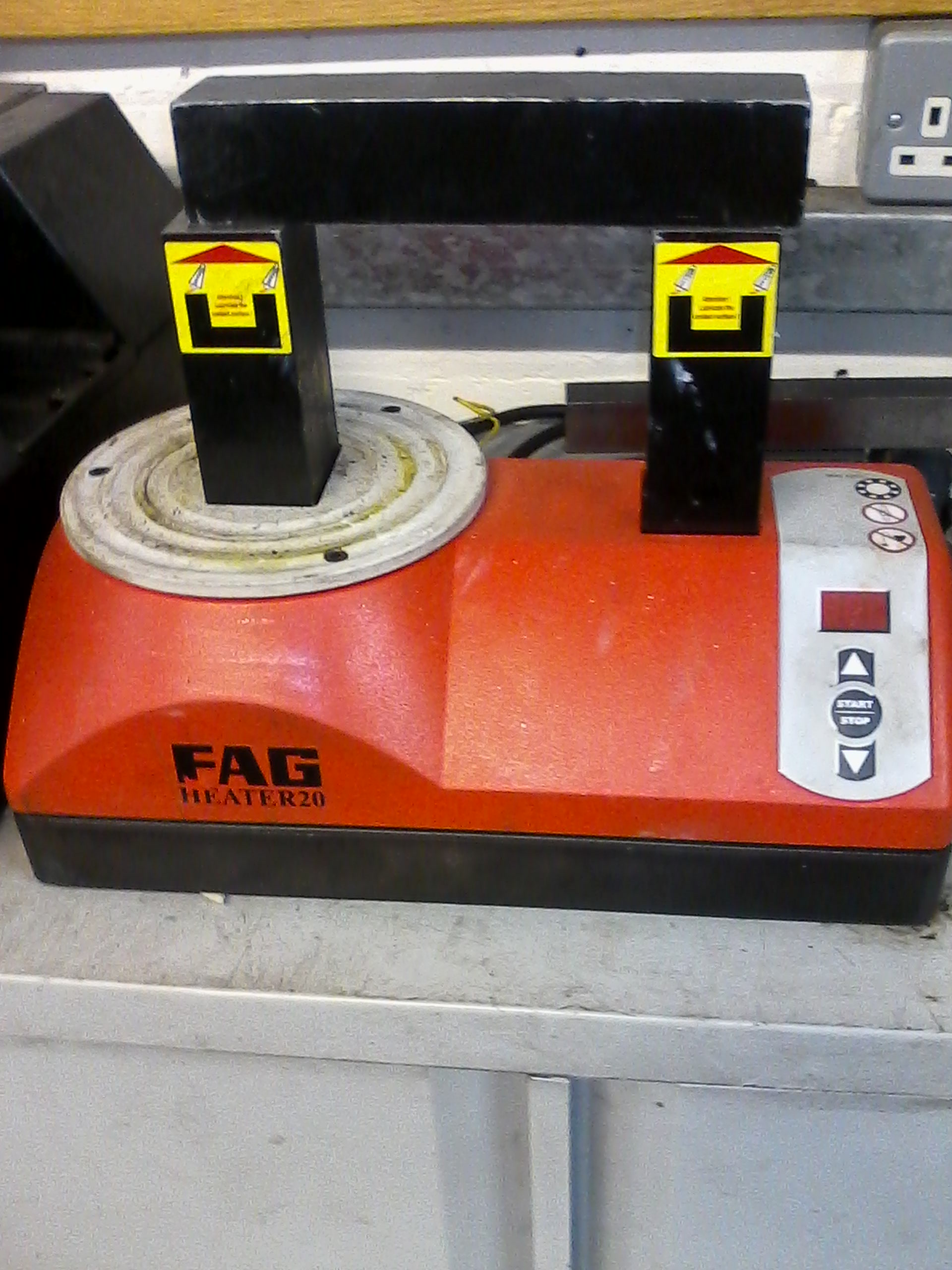

I have a bearing induction heater I use occasionally, its basically a C I transformer core, the primary (3.5kw mains) is on the C section, and the I section is removeable, you slide the bearing over it then place it on the C section, set the time and turn on, the bearing acts as a shorted secondary turn and heats up quickly, and sounds like an angry wasp on steroids.

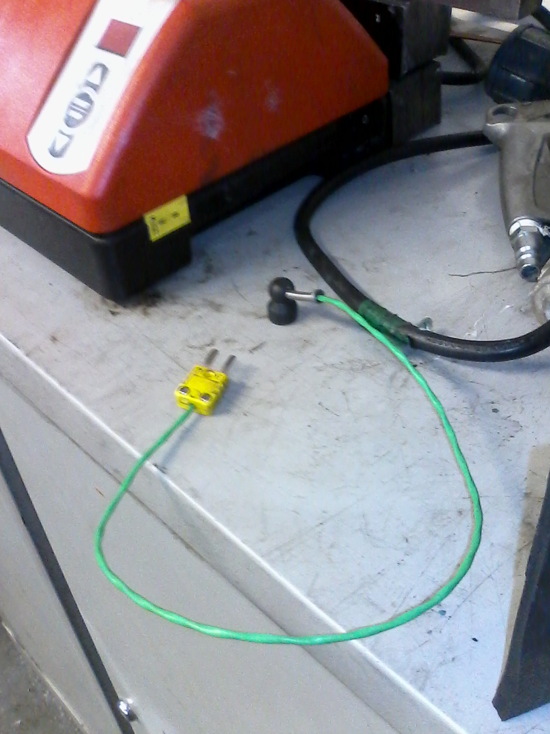

Later ones have a plug in magnetically attached thermocouple that monitors the temp, then if you cant get back to the heater when its ready at temp it will sit there maintaining temp for you, I'd like to add this function to mine with a microcontroller, as I cant allways be ready to remove the bearing esp on repetitive jobs.
The question is what steps will they have taken to make the system immune from noise, which I suspect is going to be huge from a thermocouple attached to a shorted secondary turn.
I'd have a look inside one I use now and again at another 'shop but it cost £££'s and is pretty much new, knowing me I'd bust it.
Heres the one 'borrow', the connector for the temp rpobe looks like a K type:

You can buy grounded TC probes or ungrounded ones. The grounded ones are better for noise, but can cause other issues with measurements especially with multiple thermocouples. If you care about the process a separate over-temperature cut out is employed using another thermocouple. So, the safety system disconnects power with a real relay. Control was done with an SCR/TRIAC.

Well I conducted a scientific test, I found a housing to heat instead of a expensive bearing.
For some reason my camera filtered out the racket this thing makes.
Anyway heres a K type thermocouple probe and display unit working perfectly, even with the display unit held right in the field of the machine, I was surprised it didnt blow up never mind work perfectly.
I tried a couple of diffrent units too, and also verified that the temp probe that came with the machine is a K type, that display I'm using can do J, K or T type.
