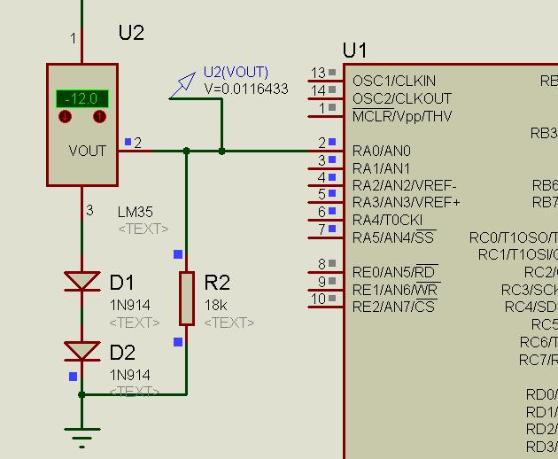

my new code with the ones output a low for PNP type.. is it correct now? for the above posted diagram which has PNP transsitors
eng1 said:
Hi Eric, is your observation directed at me? I totally agree with your point of view.
hi eng1,
No, it was just a comment to re-enforce to Derrick the limitations of using PIC sims..:)
derrick,
Which lines did you change?
I had to cut and paste the original, losing the formatting, had to reformat a line at a time.!
LOL sorry eric ... the ones in bold is the one i have changed and added ( at the display subroutine)

hi derrick,
Thats a lot better.
Digit select from msd to lsd is C2,C1,C0, nice regular selection on SIM.
Results:
0.25Vin = 025
0.5V = 051
1.0 =102
Is this what you are expecting?

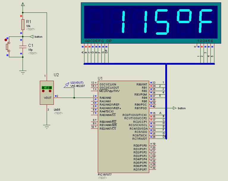

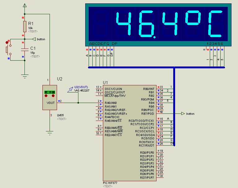

yea thanks a lot eric and the rest who have helped me... i must try in on the real hardware first.... thanks a bunch guys... might have some problems then i will post them as i need guidance... thanks a bunch!
if u need to measure room temperature,
then u can measure 0-100C temp easly w/o any software calculations
if u get 10mv/C then use an op-amp with gain 5, so max voltage to input be 5000mv = 5V (for 100C temp)
n use internal reference to VDD = 5 volts
so u get exact reading in 10bit ADC
e.g
At 30C, LM35 gives 300mv then op-amp will give 1.5V. on ADC
10 bit shows u around 300, convert it to Digits n place decimal.

This is my circuit. The button is for switching between C and F
Ive tried doing what's in the datasheet (adding the diodes and res) to be able to measure negative degrees. I think I can work with the negative, just altering my codes. But now, the problem lies with the positive ones.
