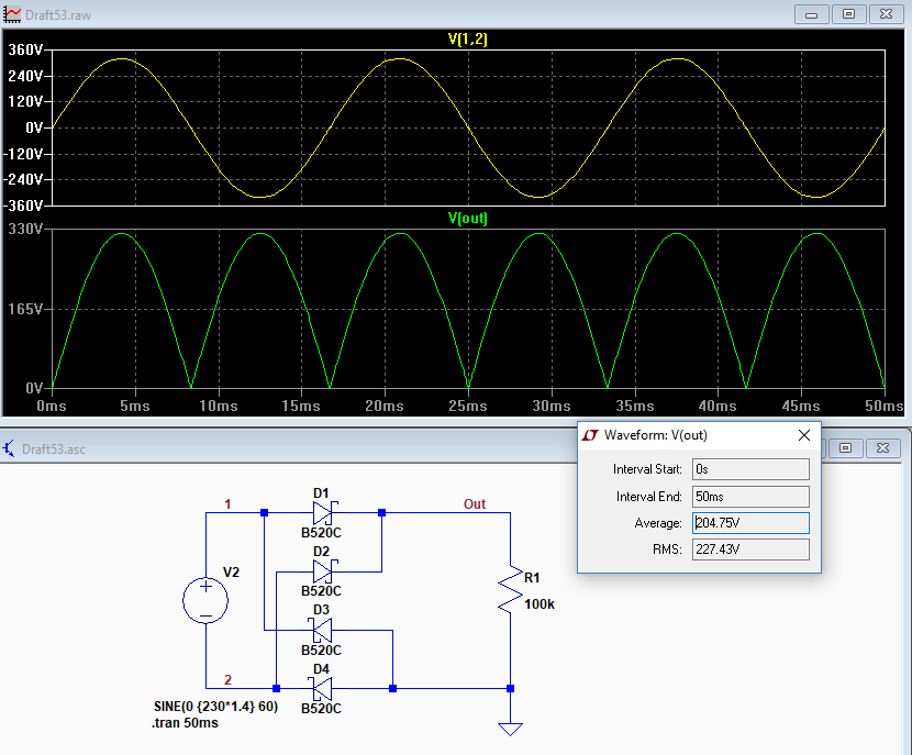

Here's a simulation to show the output from a full-wave rectified output for a 230Vac, 60Hz input (yellow trace).
Note that the output ripple is double the input frequency as Nigel noted, and that the average (DC) output is 204.75V and the RMS output is 227.4V (slightly less than I stated in post #4 due to the forward voltage drop loss of the diodes).

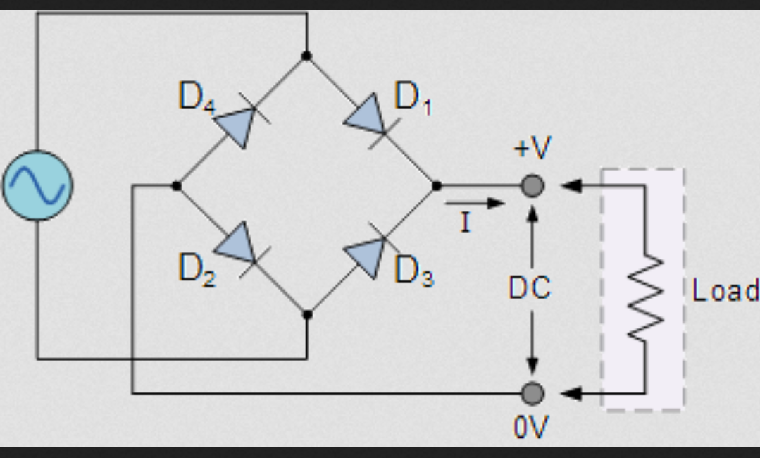

Here's a more conventional picture of a bridge rectifier circuit. It's easier to trace what happens when the sine wave is positive or negative.
