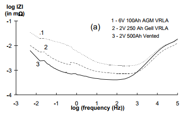

Maybe, but does anyone here actually know what the internal impedance, not internal resistance, of a lead-acid battery actually is compared to a TVS or MOV?
Here's an article, that discusses some impedance measurements of various lead-acid batteries.
Some of the results are below:
It shows an impedance in the low milliohm region over the tested frequency range, which I expect is much lower than the cheap surge suppressors they likely use in those cables.
Even expensive ones are likely higher than that.

That's the log of the millohms. So it seems to be under 1 mohm up to about 100kHz. However, the graphs do end at 100kHz and the impedance is shown to be continuously rising after that point. A TVS is around 0.5ohms and we know that they are fast enough and low impedance enough to handle ESD strikes which are much faster than 100kHz (but obviously the cable reduces effectiveness). I have no idea what the rise time of an alternator spike might be.
