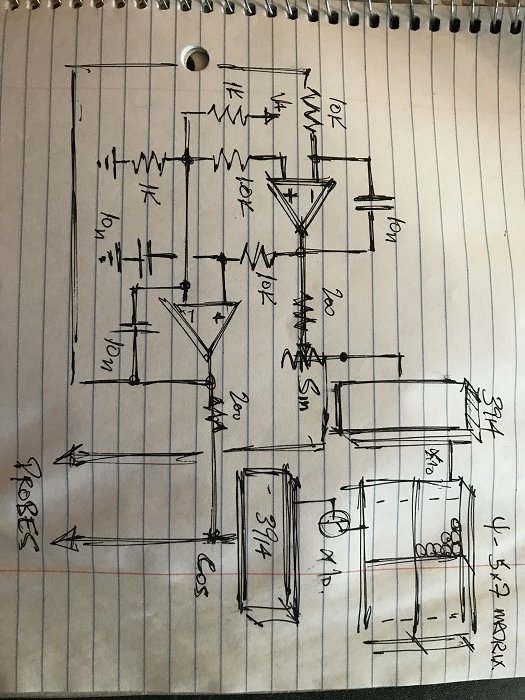

I've been putting an idea pen to paper for fun to build a slightly different integrated version using four 5 x 7 LED matrices (10 vertical x 10 horizontal - the leading and trailing two columns left no connection), the "Deflection" done via a pair of LM3914s (transistors to invert the horizontal). The original block diagram idea intended to use a textbook Wien bridge op-amp sine wave genny, but the actual schematic as IO generate it has left me a bit confused.
The displays and 3914's make an acceptable rough X/Y "'scope", and I have a single output sine wave generator referenced to 0V - but .. I'm not certain how to connect the two and incorporate component probes. As well, seems to me that I need to generate a cosine for horizontal deflection, no?
This is what I'm thinking.

With 1 x Lm3914.
Your 10 rows all commoned to the Lm3914, the cathodes for the coumns then go to a 1 of 16 decoder wired as a 1 of 10, the decoder scans the columns, the decoder being controlled by a binary counter / oscillator, the o/p of the binary counter as well as going to the 1 of 16 also goes to an R - 2R ladder / low pass filter, this generates your X sine wave, a pure sineave isnt that important.
Then this goes through an op amp etc to the device under test, the return going to the imput of the Lm3914, the display sacns horizontally and simulatneously genertaes the sinewave, which is then displayed via the Dut.

Ugh .. already having the 3914's and 2SA733's (GP PNP) on the board - and reckoning that full CMOS would allow for an unregulated battery supply that should work 5-10V I finished the mock up today.
Total rubbish.
The quadrature oscillator output was so ugly that the displayed waveform was unrecognizable and useless. Of course I did pop in a pair of 1973 dated 741's.
Considering running a dual supply with a 7660 instead of the op amps single ended and swapping out the fixed resistors for trim pots and trying to tweak the butt ugliness into something a bit more sinusoidal, but probably just wanking. I may need an entirely different OSC topology.
