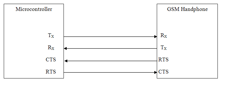

If the PC is taken away and replaced by a microcontroller. Is the microcontroller now considered a DTE? I have read that there are such things as DTE-DTE connections.
Hope that someone can help me clarify
Thanks!
The microcontroller is used instead of the PC, so the microcontroller becomes the DTE.
The transmit line on the microcontroller will send data, which is received by the receive line on the GSM device.
thank you for your reply.
With the Microcontroller as the DTE, is it correct to say that RTS and CTS lines exist for both the DTE as well as the DCE (handphone),
basically is the RTS and CTS lines in the attached figure correctly named?
thanks!

This website states that a Tx or Rx line is defined from the viewpoint of the DTE. meaning that the Microcontroller sends out data through the Tx line and the GSM Handphone receives data on the Tx line as well (DTE perspective)
If this is the case, should the RTS and CTS lines be treated equally so? If microcontroller raises RTS, the input at the handphone receiving the RTS signal is also named RTS in for instance a schematic.?
That can happen. The modules from Telit have the inputs as TX, (i.e. what you should connect to the TX line) which I find confusing.
