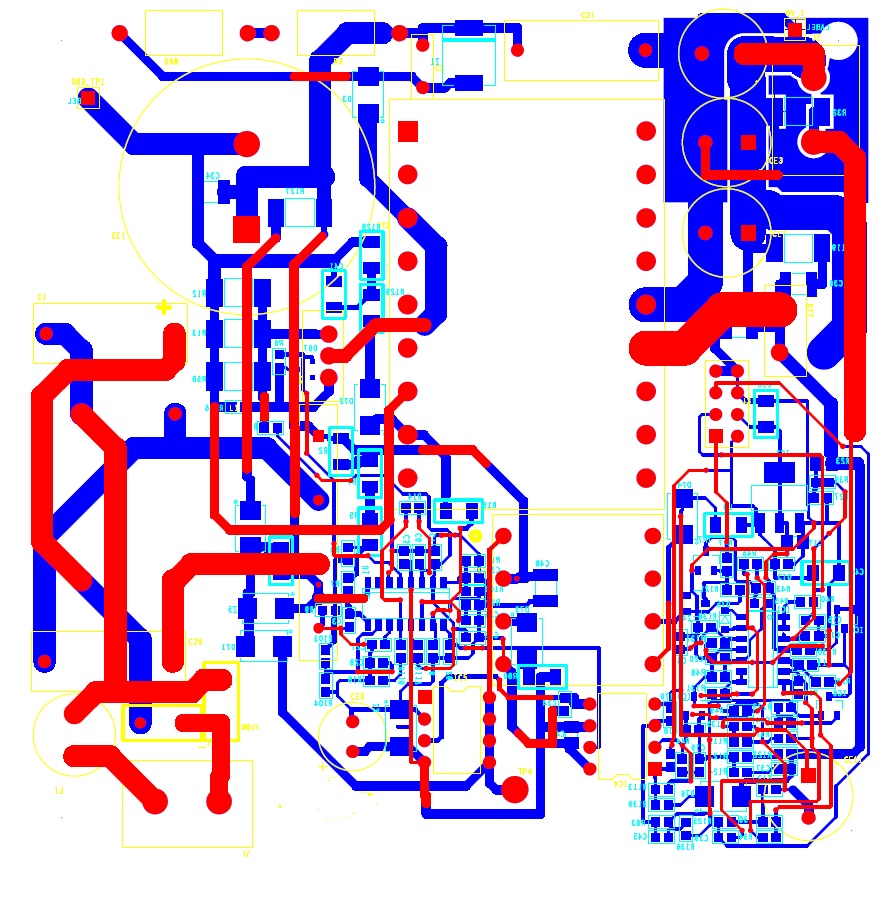

Hello,
We had a 60W offline flyback SMPS PCB layed out in an extreme rush just to get “something” ready for a customer by a certain date. (Double sided PCB)
We were then expecting the boss to allow us to re-do the PCB with a proper layout, and then test it. However, the boss then said that we must persevere with the badly layed out PCB and try and get some power out of it.
As you can see in the attached, the PCB layout is utterly diabolical.
(Red = top copper
blue = bottom copper
yellow = top silk
light blue = bottom silk)
The primary side ground is connected to pin 3 of the 16 pin pwm controller that you can see (L6566B). As you can see, there is utterly no ground plane whatsoever around this pwm controller. In fact, there is hardly any ground copper at all. In fact, the entire primary ground is a ridiculously thin trace, which goes meandering around the PCB.
The primary side ground can also be seen connecting to the large diameter , round capacitor, whose yellow silkscreen outline is visible. (round pad is primary ground, not the square one).
Anyway, despite the diabolical grounding (or lack of it), we have , sporadically managed to get some power out of this badly layed out SMPS. However, most commonly, the SMPS simply fails to start at all, or if it does manage to start, it then trips out on the L6566B’s overcurrent function (this corresponds to a current sense pin voltage of 1.5V). I don’t believe that an overcurrent actually exists, but I believe that the circuit is so noise sensitive, that the controller “thinks” that there is an overcurrent, though its actually probably just the result of severe ground bounce and general noise.
However, on a few occasions, we have indeed managed to get 20W or so out of it.
Strangely, we have only ever got it working late in the evening, never in the day time……I wonder if this is because there is simply more noisy devices running off the mains in the daytime, which is coupling noise to our poorly layed out SMPS, and preventing it from working?
Also, again strangely, we more often manage to get it working when we do NOT run it from the output of a 50Hz mains isolation transformer. Why is this? Is it because when connected to the secondary of the isolation transformer, it is floating, and not connected to ground via the neutral of our building?
Anyway, looking at the layout, are you surprised that this SMPS works at all?
(There are in fact two flybacks here, but one is just a 1W “housekeeping flyback”…incidentally, the small 1W flyback works fine)

Can you try beefing up the ground by soldering a large copper wire to the trace?
(A piece of large wire braid would be even better).
What no schema? or waveforms?
Is this the prototype?
sorry cant show the schem......waveforms....well we haven't had it working enough to get into getting waveforms........prototype, yes. Cant beef up the ground, as there is not enough existing ground to solder the "beef" to, so to speak.
Then I think you are SOL.
You also need a new boss. What's the purpose of trying to get a badly laid out board to work if it's not going into production? :confused:
Take a single sided blank PCB of the same size. Tack solder little leads to your ground points, drill holes in the blank PCB at these points then sandwich the boards together, blank board insulation side up. Solder the little leads to the copper plane of the blank PCB, and voila, you have a ground plane.
I think moffy's suggestion is the best chance you have of getting the circuit to operate properly.
Note that those "little leads" should be as short as possible, but use as large gauge wire as practical.
How do you know the issue is layout issue or excessive inductance in the Transformer ( from not using correct Litz wire ) and L/R time constant with interwinding and load capacitance and SRF vs switch rate.... that triggers shutdown.
The load regulation of an isolation transformer will be worse than the grid, but this should not be enough to cause instability with carefully selected quasi-resonating regulator.
Beware of all reference voltage ground shift spikes. This will cause hysteresis and possibly instability.
