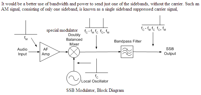

carrier filtered as a single sideband
How do i filter out sidebands? the lower and upper sides bands do i put a EQ after the modulator section/stage?
whats the difference between a suppressed-carrier signal VS a regular carrier signal?
The sidebands are at a radio frequency. An audio EQ filter doesn't work at radio frequencies. Look in the article you posted that shows an RF bandpass filter to select a sideband.
The articles that you posted explain the difference very well.
