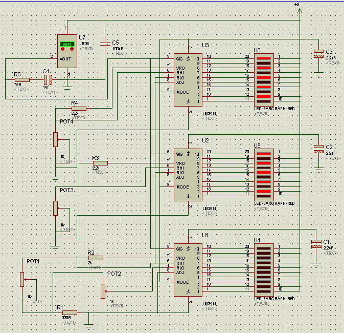

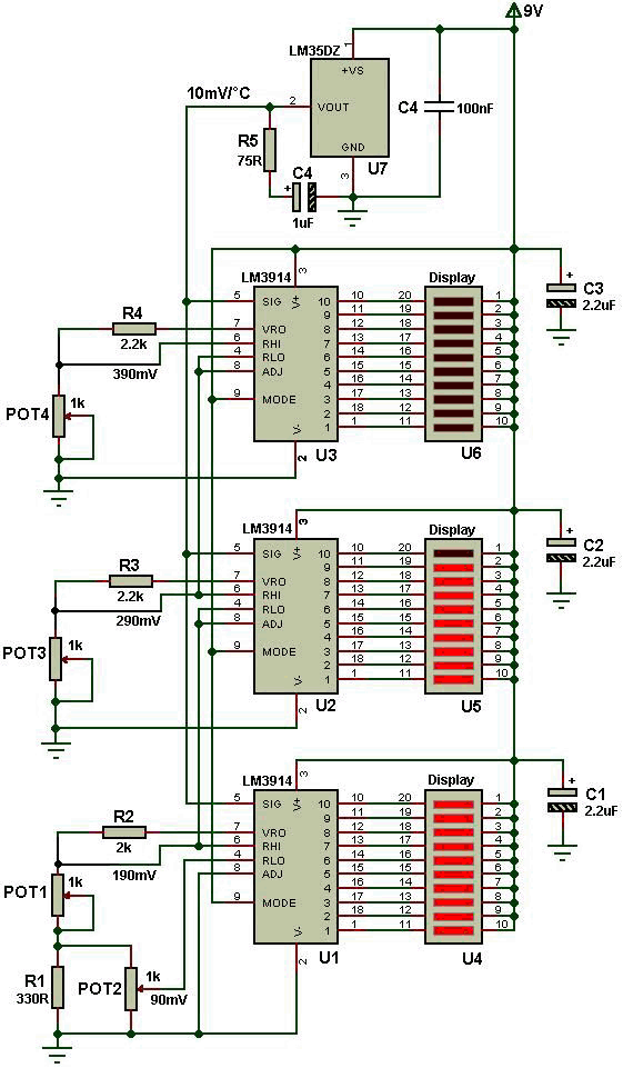

Dear all,
I built a circuit to detect temperature changes of range 10-40 degrees Celcius based on this schematic in the GIF file attachment below.
I made the schematic and run simulation based on Proteus Iris program, the file is attached below: rangebartan.dsn in a zip file
But it's been showing this problem:
1. According to GIF picture it should lights the LEDs from U4 to U6
but in my schematic and simulation it runs from U6 to U4
2. It should give a linear response to every celcius from the LM35DZ; one LED lights per celcius,
but in my simulation it has not
3. The U4 bargraph LED won't light up / turn on
Please help me with some review and suggestion and correction
Thanks God bless

The circuit gif, is drawn correctly and it should work from +100mV starting at U4 and in 10mV steps to 40C.
I suspect your simulation is at fault.
thanks for the review eric
this attachment is my capture of my schematic on simulation (clip.jpg)
still confusing me
it might be helpful also if there a proteus user would like to give it a try
something i didn't set correctly on the proteus maybe?
