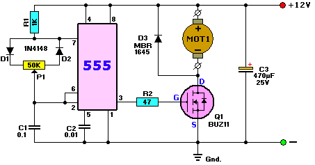

hi everybody i need to design a temperature control unit that works in acordance to light, ie: when there is minimal light then the heating element must come on, and when there is lots of light the heating element must go off...
these are the following specs of the design:
-555 timer must be used
-heating element is a 12VDC lamp (60W)
-max heat at 3cm away must 40 degrees celcius
-12VDC supply
-controlled voltage (dc chopped voltage)
-LDR
-LED's for status indications
-when the max temp is reached the circuit must switch off...
any advice and design suggestions are more than welcome
thanks alot

Would this be some sort of homework assignment?
As to using the 555 as a photocell detector (light/dark) with LED status inducators this link should serve as a start. What additional parts can be used? How do you plan to sense temperature? Temperatuire sensing I would think about a thermistor in conjunction with a comparator. A 60 Watt 12 VDC lamp is a 5 amp load so you will need to drive the lamp with a relay or MOSFET. You haven't provided much information as to this project.

Can you even get 40C with a 12V lamp? I would start with a thermo analysis to see if it can be done. Maybe you'll need more than one lamp. You'll also need a temperature sensor, a NPT thermister perhaps, and a comparator for determining when the temperature has reached the target. I guess the compare voltage can change in proportion to the light sensor. This shouldn't be too hard to do.

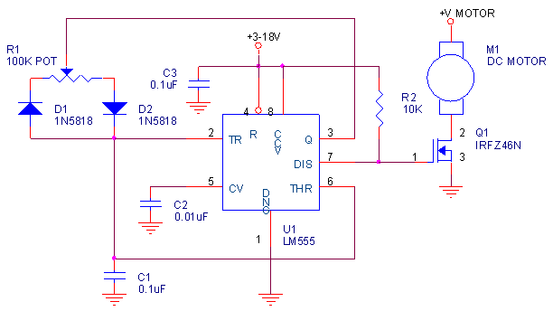

Good question, beats me. They want 40 degrees C. (104 degrees F.) which isn't that warm. They mention 12 volt automotive bulb and 60 watts in the mix. I am guessing they want to maintain a temperature of 40 C. at a distance of about 3 cm or 1.2 inches from the bulb. They want to control the temperature using chopped DC (I assume maybe PWM) and a 555 figures into things.
I would likely start with a 12 volt halogen bulb (maybe a headlamp bulb) that is about a 60 watt bulb. Figure that bulb will draw about 5 amps. Using a temperature probe (sensor) I would do as BrownOut suggest and see if at a distance of 3 cm with the bulb at full intensity you can get 40 C. This does not take into consideration like room temperature or other variables.
Assuming you can exceed 40 C. I would think about using a LDR to sense the light and configure the LDR into a circuit using a 555 with PWM. Similar to one of the attached images, maybe a scheme like that? The 50K pot being replaced by the LDR and another pot in the scheme? I am guessing here. The MOSFET actually used would need to drive the load so needs to handle maybe 7 to 10 amps for a comfort zone? The LDR would need to be shielded to see only the heat source bulb.
I don't know but that would be a very, very rough guess. :)
