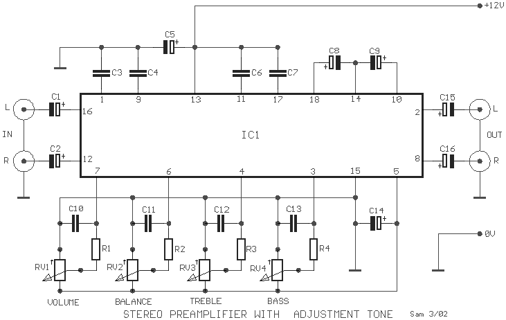

Hi, I need the datasheet for the motorola TCA5500. Or if you know, is it possible to give 15volts to it instead of 12?

I`ve not found datasheet, but here is a sematic.
I think it should work with a supply of 18V (maximum). Since the circuit requires only few milliamps of current, you could easily make a regulator using LM7812.
