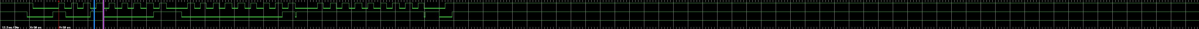

Ive been working with the I2C Bus lately and Ive finally gotten a EEprom to do Page reads and sequential writes. I had problems with it before (wrong resistors for Pullups) but got it working, so now Ive moved on to a TC1321 10 bit DAC. The device runs at 100khz from the I2C bus, by accident I had to still set up for 400Khz..opps, but Ive changed that. I have 10k Pull ups on both SDA and SCL. Ive used the Logic tool on my Junebug and the Device IS communicating and the master is sending out data, but Its just not outputting anything on the Output Pin.
If the device doesnt send out a ACK, does the master still send out data? Included is the logic tool output.
A quick read of the data sheet suggests that the data register requires a two byte write.
something like,
I2C.Initialize(I2C_100_KHZ)
I2C.Start
I2C.WriteByte(DACAddress)
I2C.WriteByte(WriteReg)
I2C.WriteByte(DATA/4)     //top 8 bits
I2C.WriteByte(DATA*64)    //bottom two bits
I2C.Stop
You may also need to write zero to the config register in case it's in standby mode.

Changed Code Accordingly, still nothing from the output

Would my previous screw up (setting the bus to 400khz) have anything to do with the device not operating? Its still responding, so Im still guessing theres something Im not doing right here.
The data sheet indicates (but isn't very clear) that the first byte sent should contain bits 9-2 (Data/4) and the second byte should contain the lowest 2 bit in the topmost position (Data*64). I can't see why this isn't working. Maybe you should try writing various values to data and read them back to confirm it is in fact communicating.
BTW, have you connected a reference voltage to Vref?
The output voltage is Vref*(Data/1024).
Yes, 2.5V Reference.
