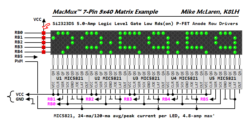

This example (below) retains your 1/5th (20%) duty cycle but I'm using MIC5821 high current 8-bit serial-to-parallel sinking driver ICs instead of your 4042/2003 IC combination. If the MIC5821 is too pricey then you could use the relatively inexpensive 74HC595/ULN2803 combination instead.
I connected the PIC PWM signal to the driver IC <latch> and <oe> pins and I'm using a PWM period equal to the row scan rate. Now I have complete fade-to-black "no overhead" PWM brightness control and the ability to re-task the row driver lines temporarily at the beginning of the row update interrupt when PWM is hi (display off) for use as <clk> and <dat> lines to load the driver IC shift registers in parallel by writing 8 special SR bytes and clock pulses onto the buss in about 26 cycles. I still need a "data bender" to build the special SR array for the next interrupt but that takes less then 100 cycles. Please note that the <clk> bit within each srdata() array byte is preset to '0'. The display ISR driver then might look like this (BoostC);

You'd still need to add your general purpose animation and process timers but the basic ISR only uses about 150 cycles and the display refresh rate with 1-msec interrupts is a whopping 200 Hz. If you're synchronizing animation to the frame rate, as you should to avoid unwanted visual artifacts, then you can change the display array up to 200 times per second (once every 5 msec display frame).
I would use a 64 step gamma correction table to linearize brightness across the PWM duty cycle range, which should in turn produce very smooth fading effects. Note that brightness is inversely proportional to PWM duty cycle. The display brightness function might look something like this (PR2 period register = 125-1);
void brightness(u08 level)      // parameter range 0..63
{ ccpr1l = 125 - gamma[level];  // level 63 =  3% duty cycle, 97% bright
}                               // level 0 = 100% duty cycle,  0% bright
Anyway, I hope you don't mind another design perspective.
Cheerful regards, Mike
