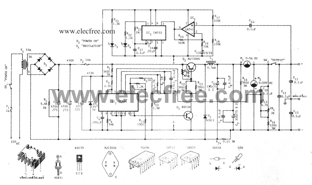

Well linear reguation generates too much heat and get really complex for high power applications like these.... i'm looking for something similar to these:

In that case, just wire it in parallel to get the current you need at ~25v, then use it as the input to a buck regulator. Which I believe is exactly what the top section of that schematic is. I think the bottom portion is over-current protection, but I'm tired and had beers so I'm not all with it right now. :p

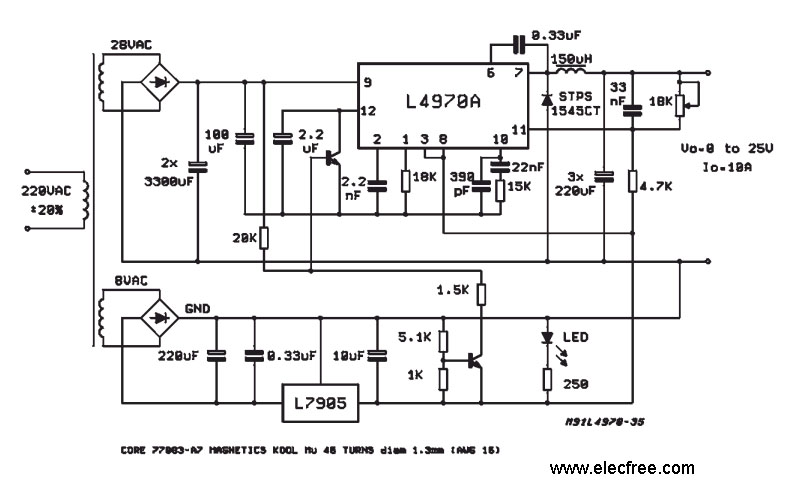

The second schematic is a much more "traditional" (and much higher power) buck converter.
ok so obviously i'll need a DPDT switch to switch between two different toroil settings and regulation circuits, how could i adjust circuit 2 to suit my needs? or can someone at least ge me some insight to how it works.... i undersstand the diode bridge and the filter capacitors... but everything afterwards is a blur... i know the concept though of the 555 timer being used to as a pulse with modulator of some sorts to turn the thing on and off at a really high frequency... but thats about it...
You should work on the various sub-circuits in this order.
- Variable duty cycle pwm controller using the 555.
- Buck circuit
- Voltage regulation feedback loop
- Over-current protection feedback loop.
Tackling each of them one at a time will be easier than trying to understand it all at once.

You can't get 25VDC from an 18VAC transformer, not without a buck-boost or SEPIC converter anyway.
The RMS voltage might be 25.5V but you'll loose some voltage in the rectifier, there'll be some ripple on the output and the voltage regulator will have a certain drop-out voltage.
To get 25V you'll need a switching regulator which can take anywhere between 20V and 30V (the transformer's output voltage will be higher off load) and convert it to 25V. A simple buck converter or boost converter can't do this, you need a SEPIC as mentioned before.
You can't get 8.88A of DC current from a 18V 8.88A transformer.
Once you've added a smoothing capacitor to get the ripple down to say 2Vp-p, the RMS value of the current going into the rectifier will be approximately 1.414 times the current leaving the filter capacitor. This means that the maximum current rating of your transformer plus rectifier is 8.88/1.414 = 6.3A. You need a 12.6A transformer to power your circuit.

A buck is easy and will still give him the most out of the transformer.
