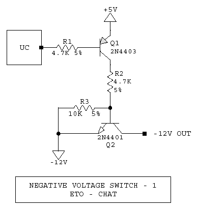

I want to switch a negative voltage with a microcontroller, the controller runs from 0 and 5v, and I need to switch -12v 100ma.
I got the thing to work with a opto isolator, but it doesnt seem very 'elegant', what would be a good way to do this with a transistor or 2.
IMO the opto isolator is a safe way to interconnect a micro with a high voltage or ??
One PNP transistor driven by the uC, one NPN transistor as the switch, and 3 resistors. 2N4403 and 4401, or 2222 and 2907, or 3906 and 3904.

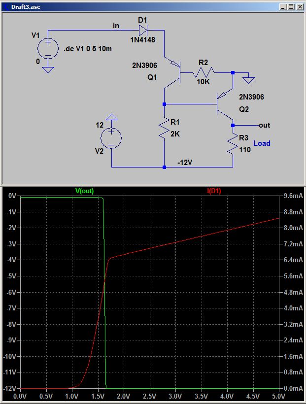

Transfer function showing switching point. X-axis in the plot is V1. Y-axis shows V(out) and current from PIC port pin.
Here's the LTspice simulation of a two transistor circuit to switch a negative supply voltage from a positive signal (which I think is what you wanted).

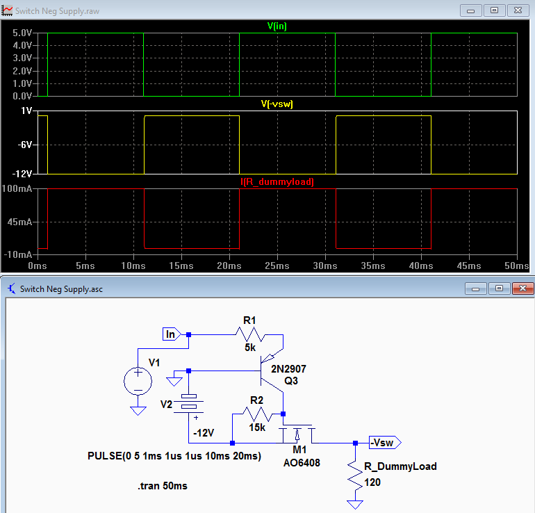

The N-MOSFET can be just about any device with a low enough ON resistance.

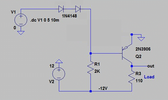

I want to switch the low side rather than the high side, looking at mikes post #6, all I need to do is mirror the circuit around Q2 and use n Npn tranny with its emmitter tied to v-, and have R1 inline with its base.
What does D1 do?
The msofet is a good idea too, I'd not thought about fets, that Aon device is pretty good at 18mohm on resistance.
Cruts, neat circuit, but you need to cut the voltage drive to the AO6408 because the +12V max VGS is exceeded.

Most MOSFETs have a 20V rating and I didn't check that one in particular.
But certainly you would need to add a base resistor for that MOSFET to reduce the maximum Vgs.
