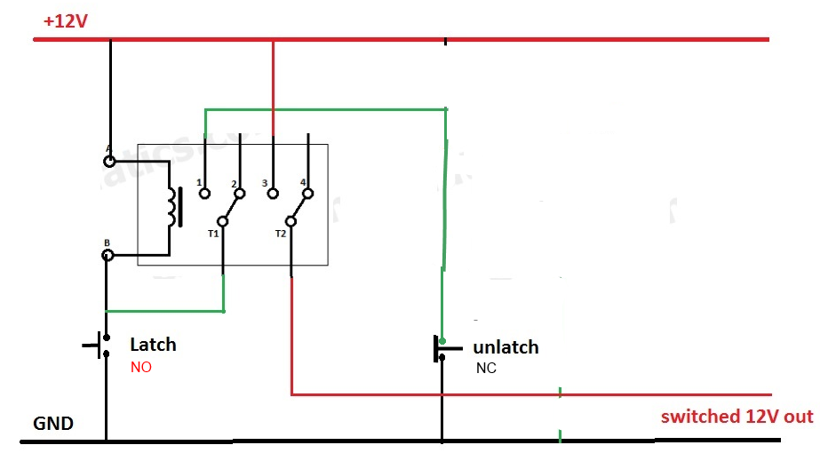

you can use DPDT relay that is available at your nearest store. not required to order and wait for delivery. see attached simple schematic.

I thought about that but did not ask if "latching" means it must remember when the power goes down.
Your circuit is good if the latch should come up in the off position (when power is applied).
Hi
How does the relay energize when power is applied? It appears to use standard non-latching relays...
I guess I’m not seeing it..
eT
If the push buttons each have a NO and NC contact, you can wire them so pushing both at the same time won’t affect the relay state.
HI
Here's one way with NO switches.
Its also a good idea to connect a diode across each coil to snub the inductive kick.
