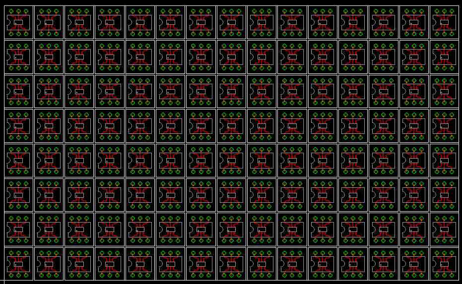

I'm planning a small project which requires one up- and on down push button. The circuit requires accurate activation pulses which I intend to produce using a debouncer circuit. So far I have found a MAX6817, but this is produced in a SOT23-6 package. I'd rather use a DIP-package type.

Hi Hans,
I don't understand the problem with the SOT23-6. There are converter boards made. Bellin Dynamic Systems makes a board that you solder the SOT to then some pin headers to convert the SOT to a DIP footprint. Jameco sells them in the US. Here is one link. Unfortunately, they are quite expensive ($45USD), but they come on a break-apart larger board and you get several adapter boards for that price. I checked the current Jameco site, and it seems the 227344 has SOT23-6 to DIP-6 on it. The Bellin number is B513.

I can see not wanting a SOT-23 if you're working with either a thru-hole protoboard or stripboard. Since you're in Thailand, you could check with either Futurlec or ETTeam to see if they have any SOT-DIP adapters. They have lots of other ones (SOIC, SSOP, LQFP, etc) in their catalog, but they may know where you could get one "locally".
https://www.futurlec.com/SMD_Adapters.shtml
https://www.etteam.com/product/13000TEST_PCB.html
Here we have this for US$1, https://www.sparkfun.com/commerce/product_info.php?products_id=717 , but there's got to be something local to you for converting the SOT part if you're otherwise OK with that part.

Hi John, hi Eric,
thanks a lot for your suggestions. That circuit will be made as a small series and I'm afraid using Thais to work with SMDs I might as well forget about them.
Here's my final solution for the adapters. US$54 for an adapter seems to me it's made of pure gold.
This board will cost me €23,95 containing 120 adapters. :D
