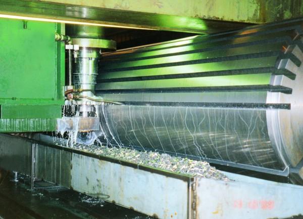

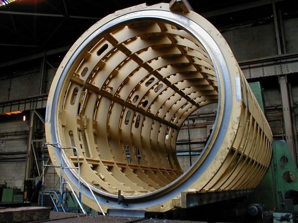

On a slightly different subject of a surprising use of a gas (to me, at least) - one of the engineering companies we used to maintain machine tools for had a lot of involvement in the power generation industry.
One thing they made was a replacement housing for an existing generator, which I remember had to undergo a massive amount of pressure and leak testing - as apparently the generator system it was going in to was hydrogen cooled!
I think they said it was to do with viscosity, hydrogen giving the best flow and heat transfer rates...
This is the thing, as it was being transported out.
Example stator frame and rotor at the same place, for some generators (probably not the above one), just as they are in the same batch of photos..

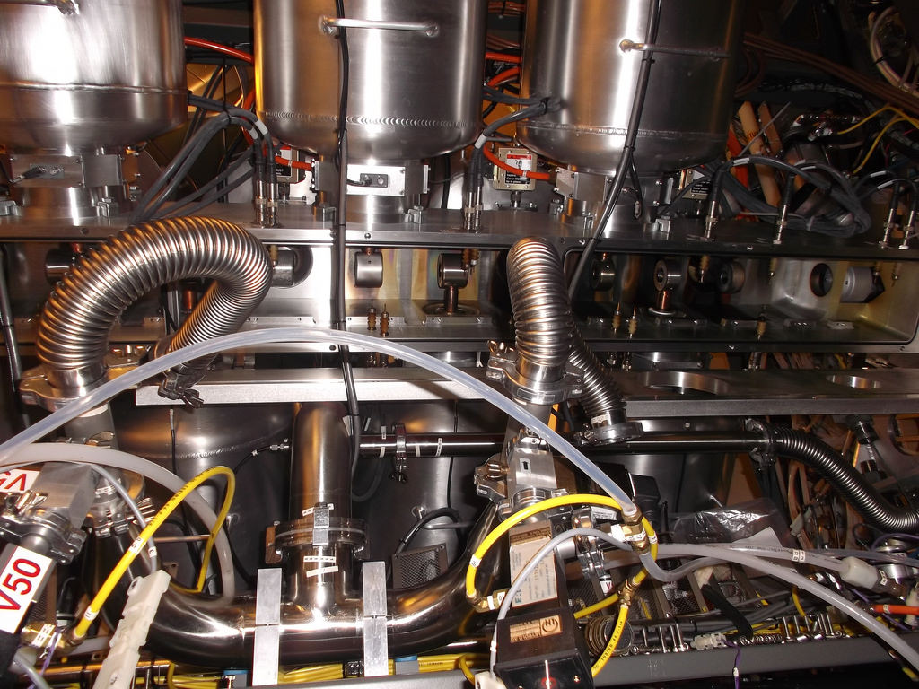

I use the stuff in RF resonators (cans on the top and bottom) for accelerator Linacs. We don't need to recycle the small amounts of the gas used in industry.
120591
When you see lot's of stainless steel and shiny bits, you just KNOW it's expensive! :D

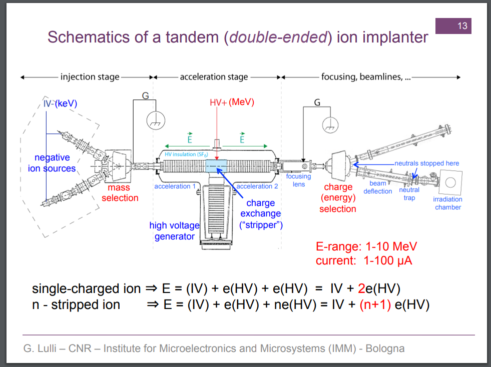

The alternative to that expensive machine is another expensive machine that also uses SF6 in a massive pressure vessel. The TANDETRON. The last time I worked on one (3MeV double ion charge) was about 20 years ago. The principle is still used in semiconductor production fabs but with the addition of magnesium cloud charge exchange (negative ion source) for some normally positive generated ION species.
https://www.iitk.ac.in/ibc/Tandem_Accl.pdf
https://www.bo.imm.cnr.it/users/lulli/didattica/Resources/Lulli_2014.pdf
