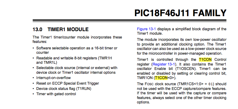

OK.... The MPLAB sim release notes say that timer 1 isn't working on the pic18f46j11 devices... I'm wondering if the same applies to this chip..
i also need to find where it says this in the release notes as i would need to doccument it, so im going to have a look for that tonight too.
File menu.... Help ... Release notes.... MPLAB sim....
Half way down..
Just had a look, Ian, Mike, i think you're right if timer 1 has problems in the 18F46j11, then the same can be said for that of the one that i chose.
They're one in the same, in fact the datasheet for the PIC18F46J11 always talks in terms of the former...
