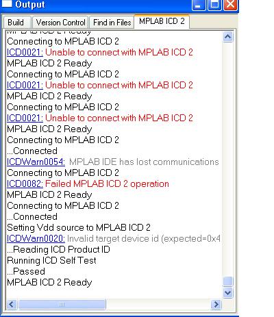

williB New Member Mar 5, 2007 #1 yay it was a bad crystal.. Attachments success.JPG 50.1 KB · Views: 189

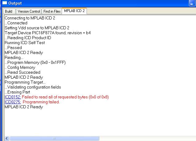

williB New Member Mar 5, 2007 #3 what i did to fix the problem should have been your question. here is what i have so far , about to start programming Attachments yay.JPG 26.4 KB · Views: 186

blueroomelectronics Well-Known Member Mar 5, 2007 #5 Wow a broken crystal (second one I've heard of) is about the toughest problem to fix. Congratulations.

williB New Member Mar 5, 2007 #6 blueroomelectronics said: Wow a broken crystal (second one I've heard of) is about the toughest problem to fix. Congratulations. Click to expand... yeah it was a tough one. i would like to start programming , but i got the error shown in my previous post , what did i do wrong? what steps should i do to get this baby working?

blueroomelectronics Well-Known Member Mar 5, 2007 #7 What sort of program are you trying to load onto it? It indicated you read from it then erased it then attempted to program. How long is the programming cable; keep it short. Also make sure the FIFO buffers are off for the com port. Last edited: Mar 5, 2007

williB New Member Mar 5, 2007 #8 blueroomelectronics said: What sort of program are you trying to load onto it? It indicated you read from it then erased it then attempted to program. How long is the programming cable; keep it short. Also make sure the FIFO buffers are off for the com port. Click to expand... Yeah i must admit this mplab is harder to use than my old programmer. It indicated you read from it then erased it then attempted to program. Click to expand... i dont know why it did that. i must have told it to do that. .i dont really know.. i think what i should do is un install it , and start over oh the cable is approx eight inches long FIFO buffers are off
