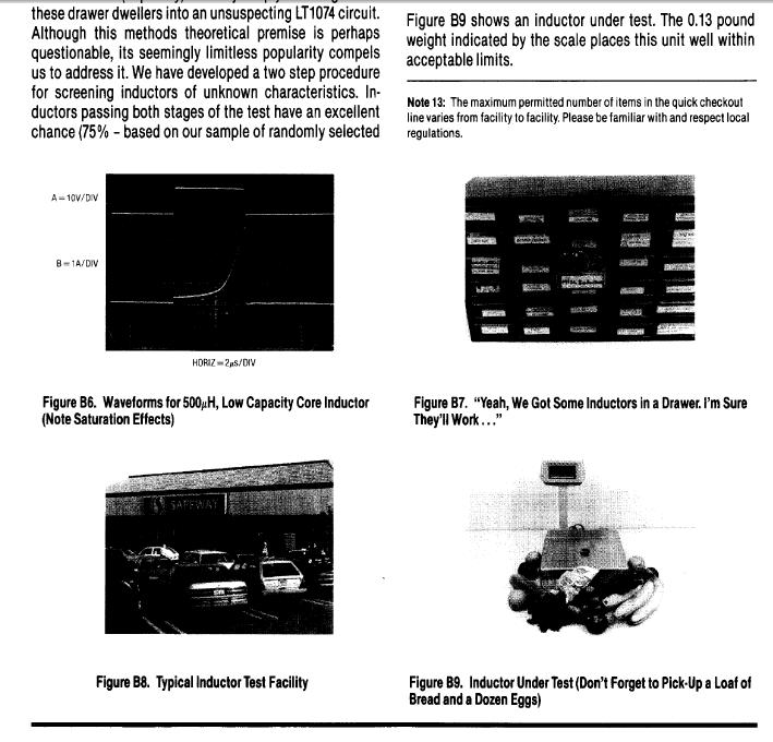

Any ideas ? I've got a fantastic datasheet/writeup from Linear Technology which basically says:
Choosing an inductor .....
Weigh it
Look at it
Measure the resistance
Toss a coin
Use it if all above within parameters :D

Here are some cracking extracts from the LT datasheet
Providing the two inductors are not mutually coupled you can connect two 100uH in parallel to give 50uH.
Keep the phasing the same.
I've had a read through their "less official" datasheet and it shows the LT1074 being used with a variety of inductors from 25uH to 150uH so I think a 100uH shouldn't trouble it too much.
