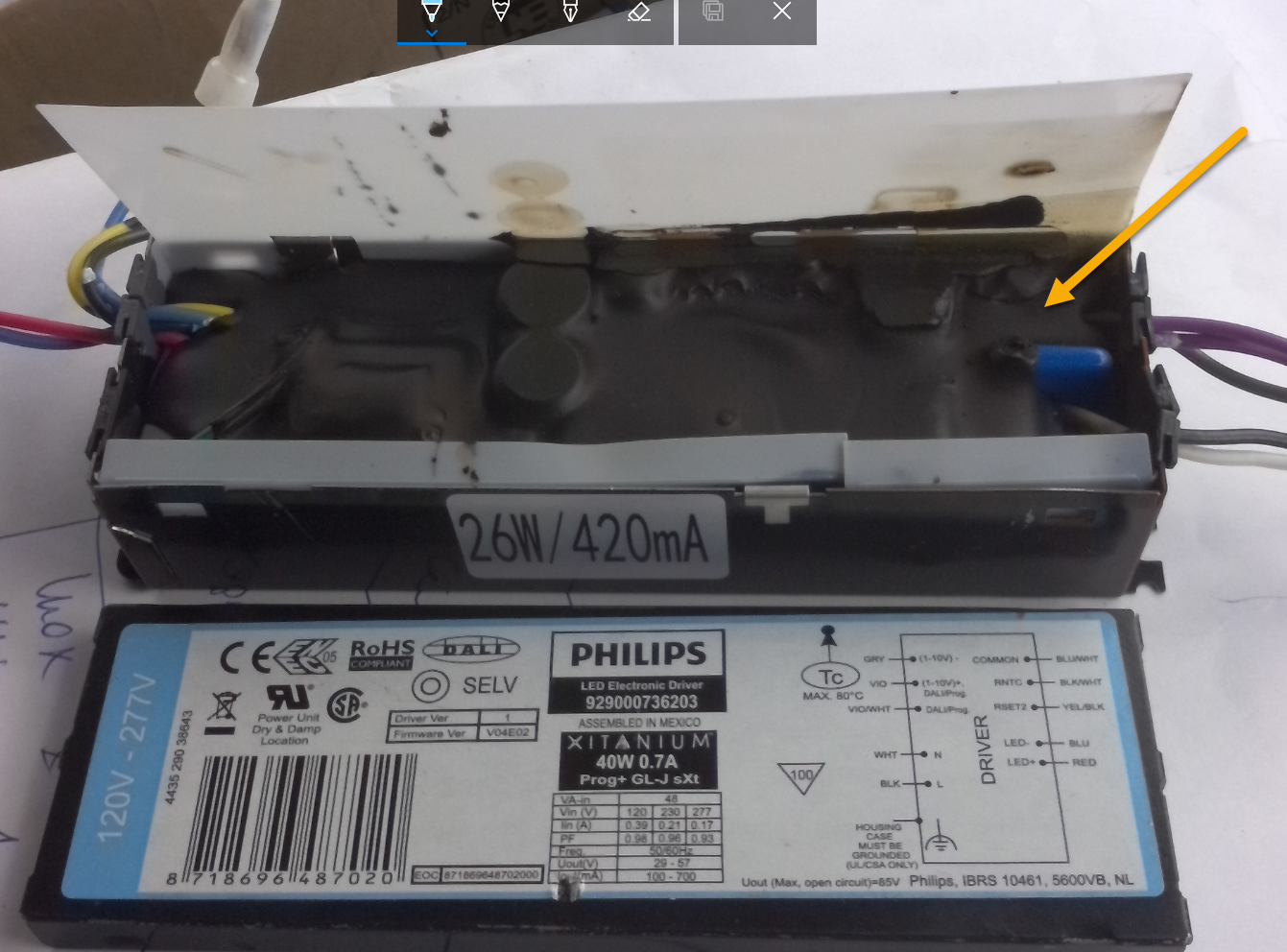

Just reading your post, had one of these potted units fail on a streetlight. Vented near the blue device, I think it was a Capacitor. 2018-09-11_12-03-10.png Where the yellow arrow is, something near the blue device vented.
This is an epoxied, encapsulated unit.
