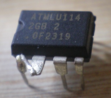

I've got few IC from local flea market along with some other stuff. I don't know whether it's EPROM or anything else. Here is the image. Google unable to retrieve any useful information !:confused:
In first line : ATMLU114
In 2nd line : 2GB 2
In 3rd line : .0F2319
It's pin no. 2 is shorted with pin no. 1
Anybody could pl. tell me what's the IC it is?
Hi Bhadresh,
What you have there my friend, is a ATMEL AT24C1024B (2.5volt t0 5.5volt) 2 wire serial eeprom
See attached pdf datasheet .....refer to "ODDBALL" chip marking on
..............................................page 16, subsection 8.6, 8-PDIP (2.5V)
hope this helps,
Rotarymaker

Hi Rotarymaker,
Thanks for your reply.
As I guessed, but when I put this in serial EPROM programmer it wasn't detected. Anyway I'll specifically select IC No. & try to burn.
