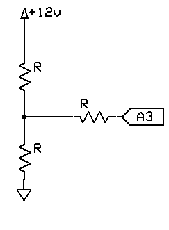

well i was also after the lowest possible part count and with 15.6 mV resolution (on a 0-16 volt scale) i think it leaves enough margin to play with as accuracy to 0.1 v is fine, the original design is meant for a motobike so space is a premium, so what voltages would you suggest ?
my only worry is if it gets over 16 volts (which it should not) if it will damage the pic via the ADC pin but I'm not sure if just slapping a 5.1 v zenner on the input will help as it needs current though it to work proporly does't it ? and that will ruin the lenear working of the voltage divider to work
Put a current limiting resistor on the input pin like this
Your using gp4 pin 3 right . As long as you keep the pin below 20mA you should not have to worry. You probably don't need it
