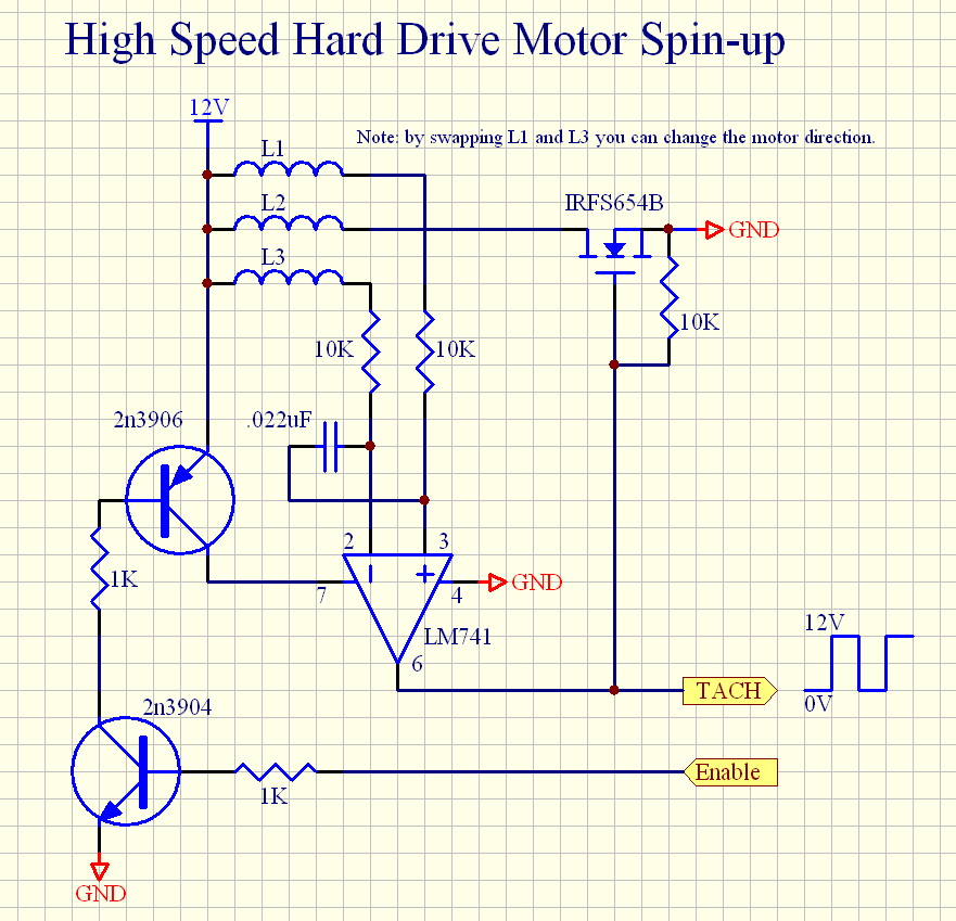

I have a schematic that drives a bldc using one phase, it only produces a fraction of the motors capacity torque wise, but on the motors I've tried it the speed was very high, gyroscope high.
Let me know I'll dig it out if you want.
Please do post it if you can.
Cheers
Ok then, I'll point out this is not my idea, I copied the schematic off the net, I dont claim credit for this one, by the way the motors I ran with this worked best with a 100n cap, and I used a irf540 and a irf740 fet both were ok, I also disnt bother with either transistors or the 1 k resistors, I just connected pin 7 of the '741 to +12, I didnt need speed or tach signals.
Heres the schem:
And heres a youtube link to it:
https://www.youtube.com/watch?v=LwruLrhchcE
