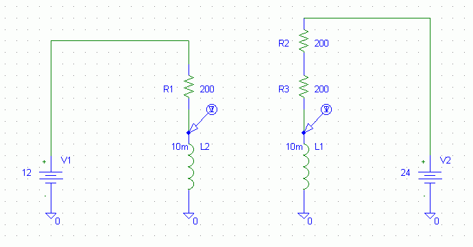

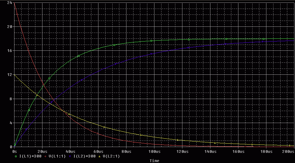

You are mistaken. The current increases faster because of the higher voltage across the inductor; thus you will get more 'kick' (torque) when you try to run your stepper faster. If you don't understand why the current increases at a faster rate, try simulating the coil at 12V, and a coil at 24V with the series resistor.
What inductance should I use?
Whatever you feel like.
Attached is a sim using a stepper coil modeled as 10mH+200ohms. Supplies are 12V, and 24V + 200ohm series resistor.
