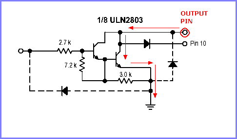

I am using an ULN2803 to drive a stepper. I want to supply 5v to my stepper, but the output pins of 2803 reach 3V (max). I am connecting the pic to pins 1,2,3,4 of the ULN2803. Pins 9 and 10 of 2803 are connected to gnd and +5V. If I increase the pin 10 voltage to 12V, will I get 5 V at the output of the 2803 ?
Best regards,
Pedro Cardoso
NO. The ULN2803 does not give you any output voltage. It is just a open collector transistor with driving transistor (darlington connection).
The function of ULN2803 is like a switch. Its output pin passes current to ground or open circuit, depending on the input.
If you increase the pin10 voltage to +12V, then the ULN2803 can drive a load with +11V or more. So if you want to drive a stepper with 5V, then provide 5-6V for pin 10 and the common coil terminal of the stepper motor.

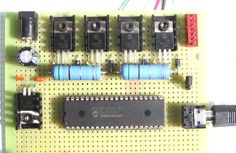

Pedro (Netbug),
I experimented with some 5v/1a stepper motors earlier this year... When I first ran them from a 7805 regulator, my regulator also got very hot and the steppers did not have very good torque... Also, when I tried to drive two coil windings at the same time, the 7805 would shut down...
I suspect multiple 7805 regulators would work ok if your power supply can supply the extra power...
I installed 5 watt current limiting resistors in series with both "common" coil windings and connected these "common" windings to the 12 volt (3 amp) source on the "input side" of my 7805 regulator and the steppers have excellent torque and speed now...
Good luck with your project... Regards, Mike

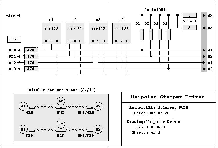

Pedro,
If your steppers are 1 amp, are you then driving each coil winding with two '2803 outputs?
I almost used a '2803 for my steppers but I was worried about running two outputs simultaneously at the full 500-ma spec'... I guess I figured that tiny little DIP-18 chip would have to get real hot... I ended up using TIP-122 Darlington transistors and they don't even get warm...
I used 5-ohm 5-watt resistors but they probably should be more like 7 or 8 ohms... Another advantage of the "current limiting" scheme is that when you first energize a coil, it gets a boosted voltage until the current ramps up enough to develop the voltage drop across the resistor... This provides excellent torque...
Regards, Mike

Mike, K8LH:
The losses in the transistors will be lower if the current limiting resistors is inserted between Ax & BX & 12V.

Mike, K8LH,
When I bought the stepper I had the specs of the 2803 on my hand, so the stepper must be 500 mA (max). I am sorry for the confusion. But I measured the total current in circuit and it gave me something around 350 mA. The 2803 didn't even get warm, it is cold all the time. The heat problem is only with the 7805.
I will try to put the resistors and I will post again with the correct data from the stepper.
Pedro
You would lost around 1.5V across the 2803 at this current. Mike's advice of using two output pins to drive one coil is very good.
