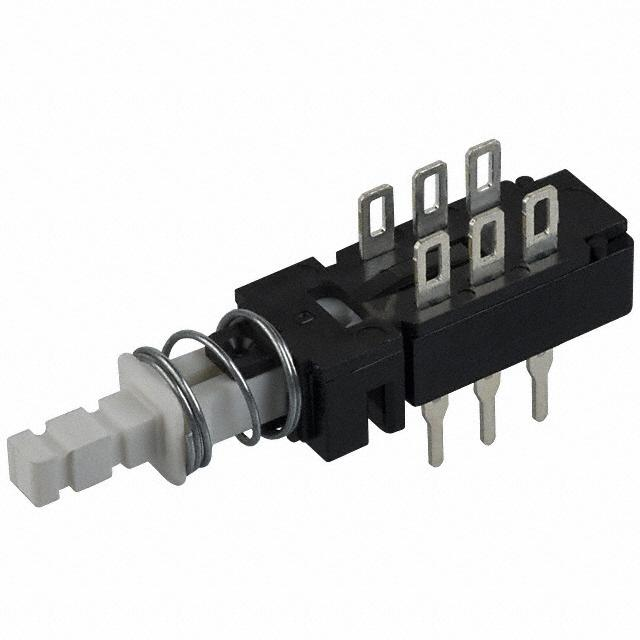

I can not find what I am looking for. This is a push button switch. It can be set to latch. Push on-Push off.
I have used them in a bank. In your case 12 next to each other. Switch 5 is on and all the rest are off. If you push button 7 as it turns on it will release all of the switches that are on. (wants to have only one on at a time)
There is a piece of metal that hold all 12 switches together and resets all the switches at one time.
I have seen these used on very old car radios and some TV sets to set channels.

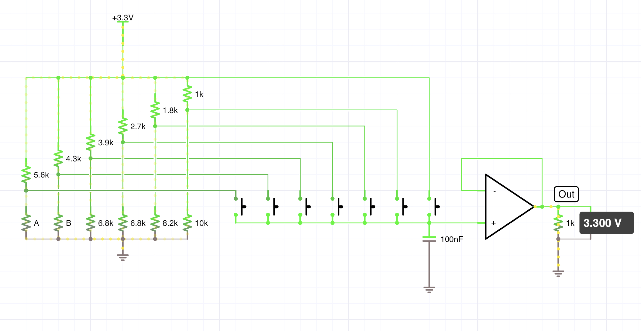

Without using a microcontroller, an easy way will be as follows. Only 7 voltages drawn to save space.
This **assumes** you will push a button every 10 minutes to an hour. You may see a few mV sag over longer periods of time.
Use a good quality/low leakage film capacitor.
Instead of the resistor pairs, use 15-turn trimmers to dial in each of the 12 voltages.
Use an op amp with JFET inputs so no current flows into them.
The purely mechanical ones with one-of-many latching action are generically called "Radio switches" as a common use was channel selectors.
You can still buy the switches and mounting rails to make these up from some switch manufacturers, eg. Switchcraft.

Or if the voltage output after a selection is only needed for a few minutes or tens of minutes, just go with Gophert's capacitor hold circuit - that's a simple and straightforward as you can get!

I love your proposal Gophert, I think this is exactly what I was looking for. It is ok if the voltage start to drop after ten minutes, specially since I will program steps in my effect processor, meaning that for exemple, if the voltage is 0.9v and drop to 0.8v after a while, it will still be on the same step.
I am going to do some testing this week and tell you how it goes.

Your op amp will need 5 or more volts in most cases (few op amps can put output all the way to 3.3v when powered by 3.3v)..
Also, use 10k or 20k ohm trimmers - if you get up to megohms, a very quick button press may not allow the capacitor to charge/discharge to your target voltage. 10k ohm trimmers will insure the cap charges within 5mSec.

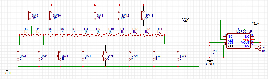

Why not use a single series voltage divider (11x1k)? Last resistor could be trimmer(?)

Thank you for your input. Something like this?
118535
If this work, this would be very easy to wire.
If two buttons are pressed at the same time, hopefully the last one pushed will print his value. I guess I need to test for that.
You'll need one button connected to Vcc and one to Vee of you need 3.3 and 0V as in your original post, but, yes, that resistor ladder should work.

This is called a "radio button" circuit because it acts like old car radios with pushbutton tuners. You have two options. First, 12 switches interlinked mechanically with a "bale". Press any switch, it latches down, and all other switches pop up. This works only if all 12 switches are in a row. Switches like the one pictured in post #2 were very popular for this back in the 80's.

I finally made some tests today, it works great ! Sometime the output tension was not very stable on the further right switches, I added a resistor after R14 so that the tension before the OPamp is a bit smaller. Now I can draw the final board and make it happen ! I will keep you posted with pictures.
