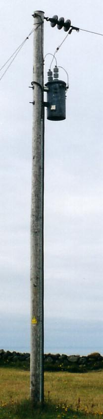

I have seen local distribution systems which use just one wire!
The return is done via the earth.
This was in Iceland, have a look at the attached picture, this is the power feed to a clifftop lighthouse at Dyrholaey on the south coast.
Curious stuff, I wonder what the load regulation is like?

Perhaps being near the sea the ground has a high salt content, making ti a good conductor.
That lighthouse supply is bizarre, the return current actually flows through the earth, not a wire? I thought even a few metres of earth would have many hundreds of ohms resistance and would render the supply useless except for signals?

You obviously didn't click on the Wikipedia link a few posts earlier - give that a try!.
Even after reading it I don't think I understand it. I see it uses a higher voltage at around 19Kv to help overcome losses, but also talkes about 36mile runs? I mean, if I put a multimeter with one end in Bristol and one here in Swindon i'm sure it'd read right off the scale, way over 2M ohms? Or mabye it conducts better with HV and current flowing through it?
How many wires do you think they used in the Wild West for the telegraph systems? - just the one! - with the return through the ground.
I thought the Wikipedia article suggested a ground resistance value?, it will be fairly low - bear in mind there's a LOT! of it, all in parallel. The reason for the high voltage, as with all electrical distribution, is to reduce the current and lower the losses. It's only to your home at 120V or 230V, elsewhere it's much higher.
In this case the ground is highly conductive because it's saturated with salt water and they're probably using a high quality earth connection consisting of a very large metal plate buried deep underground, therefore resistance will be very low.

Well the Wikipedia article you posted says:
A good earth connection is normally a 6 m stake of copper-clad steel driven vertically into the ground, and bonded to the transformer earth and tank. A good ground resistance is 5-10 ohms.
I suppose so, I just find it wierd, I mean if you were to wrap a thin layer of platic over the earth rod it would completely break the circuit, so to imagine it travelling through many miles of earth without significant loss seems odd.
