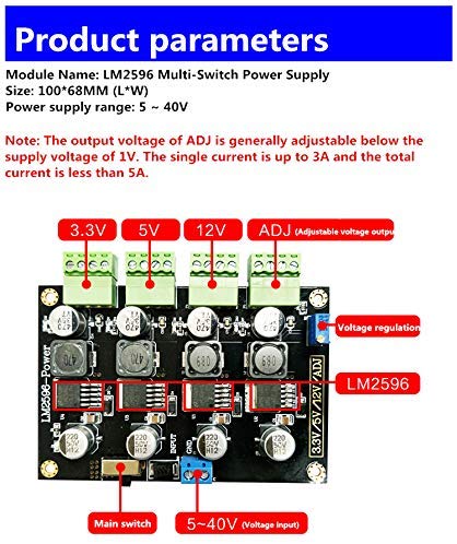

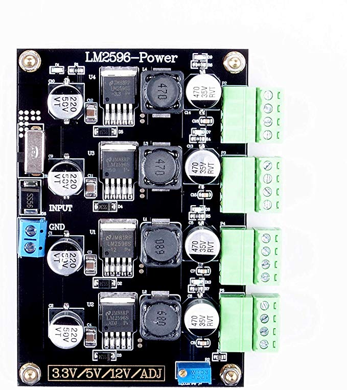

Hey all I have been searching for a already-built solution that would output 3.3vdc, 5vdc and 12vdc @ 5a. I have found that here:
enter image description here
However the issue is that I will be feeding this 48vdc (POE) and it seems that the max this thing can take in is 40v.
Do you think it will be fine with 48v? Is there anything I could add to the board so that it can take up to 50v?

The LM2596 rated maximum is 40VDC. Can't see much you can do about this?
You could perhaps drop the voltage from 48VDC to 40VDC using a number of appropriately rated diodes?
Be aware that 48v 'POE' is only about 2Amps max, so you have to judiciously pick and choose which of your 4 outputs you 'really' want to powersomething on at that time.

Doesn't the board produce the ~5a itself and not what the poe cable can carry? I would need to use 3 of the 4 outputs for what I'm doing.

I think you may have to do it in two stages; a 12V output unit, 10A or more with a suitably high input voltage rating - 60V seems common - then run a separate 12V to 5V + 3.3V one from that.
