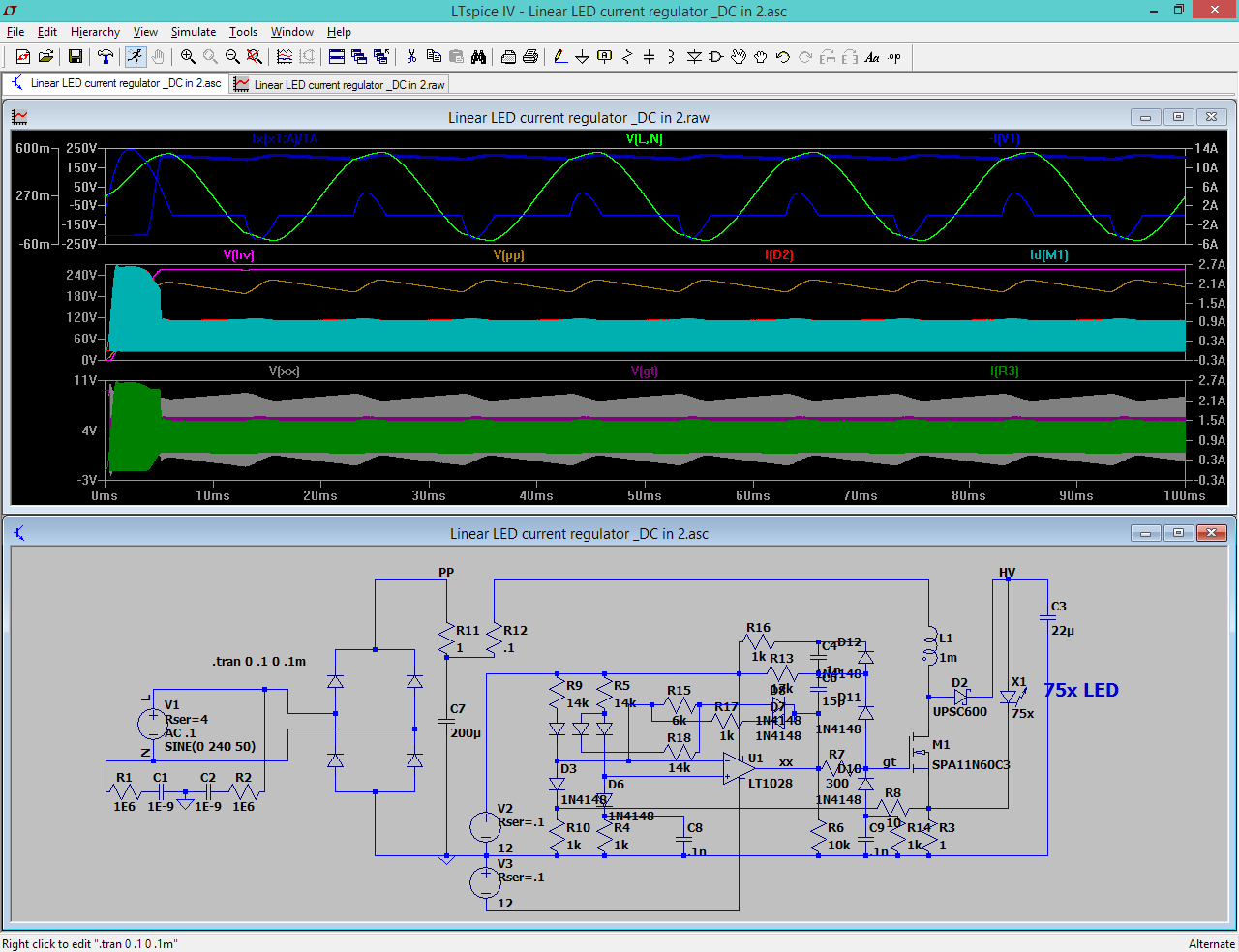

We wish to do stability testing on our linear LED current regulator. It is actually mains connected.
The designer tells us that he has some worry about instability occurring. He says that we should stick to a certain family of the Infineon range of FETs so that the circuit stays stable.
I must admit I have not had chance to do much stability testing with the hardware yet, but on the simulator, making even large changes to all the circuit values around this LED current regulator don’t appear to be bringing any instability at all.
Do you believe that the attached circuit diagram would be a valid test to check for instability of this current regulator?
The company will not mind me posting this bit of the circuit as its just a well known standard linear current regulator.
I also attach the LTspice simulation of the regulator.
looks ok to test thus way.
-all you really need is to measure load step and line transient response with overshoot energy. (watt-s) under all conditions and test or calculate Tj rise of LED. Because the phase margin changes during turn on and turn off. so Bode Plots are limited use.
instability depends on load capacitance in LED cable and diodes on off state.
Qg = 64 nC = CV, Ic=CdV/dt if we use Vgs =4=dV and dV/dt=0.4V/us so that CdV=Qg=64nC then dt=10us
thus Ig= 64n / 10us = 6.4 mA which is within IC drive limits.
so unless there are positive feedback parasitics, it should be fine
Proper probe methods with 5mm coaxial spring on 10:1 probe with clip gnd wire removed are essential.

I know L/R is .1/50 =0.02 s and Coss is small and damped by 1.2 ohms , so where do think the resonance comes from ? FET model Coss? 47pF+10k?
With Vf of 75* 3.2 = 240V (unless these are really cheap LEDs @ 1V/1.2 A
the. MOSFET Vds *Id can be as high as (339 -240)/1.2= 82.5 watts !!
Put in a hysteretic choke and cap for 50kHz ,
- since ESR of LEDs is kN/Pd= k* 75/3W for k = 0.5 to 1 depending on ESR quality with N=75Series LEDs , then ESR= 13 to 25 Ohms for LED string, so choose Z(f) average on PFM series resonant choke to be around 25 Ohms Driver RdsOn modulates by duty cycle so Z_FET= RdsOn/ d.f. for d.f. near 75 to 90% (est.) thus low Q hysteric PFM buck regulator.

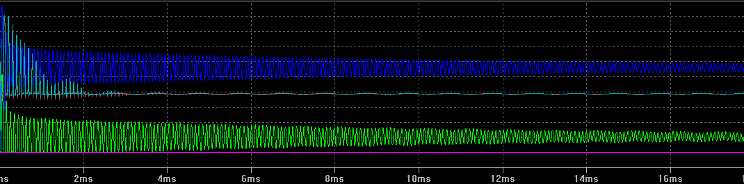

My latest hunch is that the Op Amp cannot drive Vgs fast enough with current limit so poor phase margin. I=20mA = CissdV/dt
Looks like my hunch was close and your client was correct. It's unstable. RdsOn is a bit too low ( I picked 900mOhm ) and drive current to gate is too low ( so I added complementary emitter follower to gate) with 2 pole compensation.
Then I can see some overshoot but resonant free.
I just realized, I dont really like LTspice for show N tell (PITA) but it does serve a purpose with device models.
Your solution ought to include;
  1. consider adding RC delay to 1V reference for startup overshoot reduction. e.g. 10k+10nF
  2. add LC filter to MOSFET drain to prevent LED capacitance resonance.
    1. from low Z switched MOSFET source creates high Q instability
    2. due to LED shunt capacitance before being turned ON and series LC parasitic resonance
    3. e.g. Drain to 1 uH series to 1 uF shunt to LED string cathode, finally eliminates all resonance.

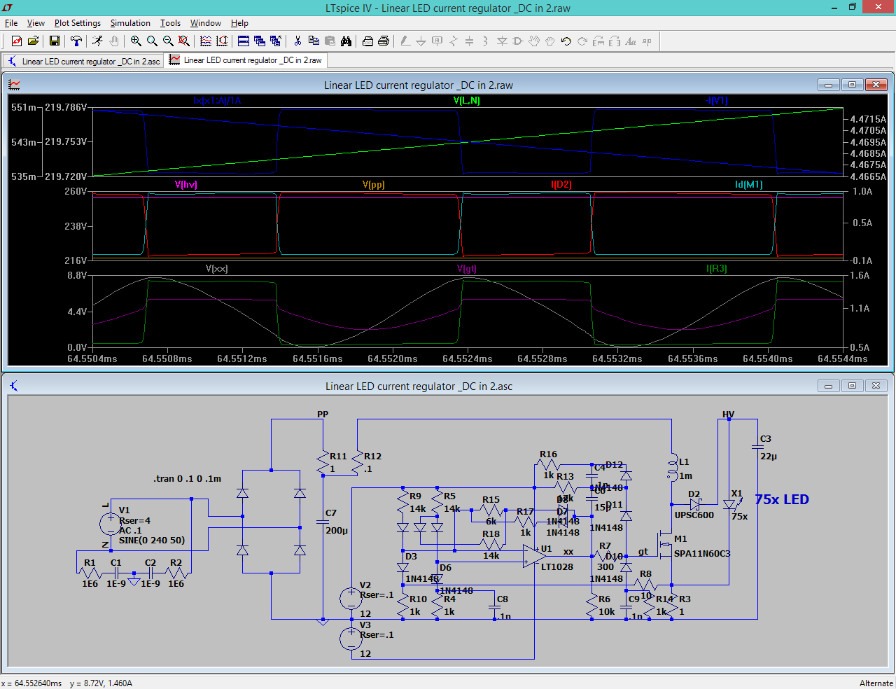

51.69W yes, but it is not on all the time, only short duty, and in the real circuit there is less voltage headroom
you use DC HV source and no capacitors - to smooth out the Sine at Zero + Nπ rad takes quite large capacity for 600mA
the GRID ward going line noise can be likely filtered out for switching supply or perhaps you may externally regulate @100Hz to pass/dismiss entire half cycles ?

To understand Conducted line noise, you must simulate I(V1(t)) not V1 which is incorrectly modelled with 0 Ohms..try again.
simulate I(V1(t))
